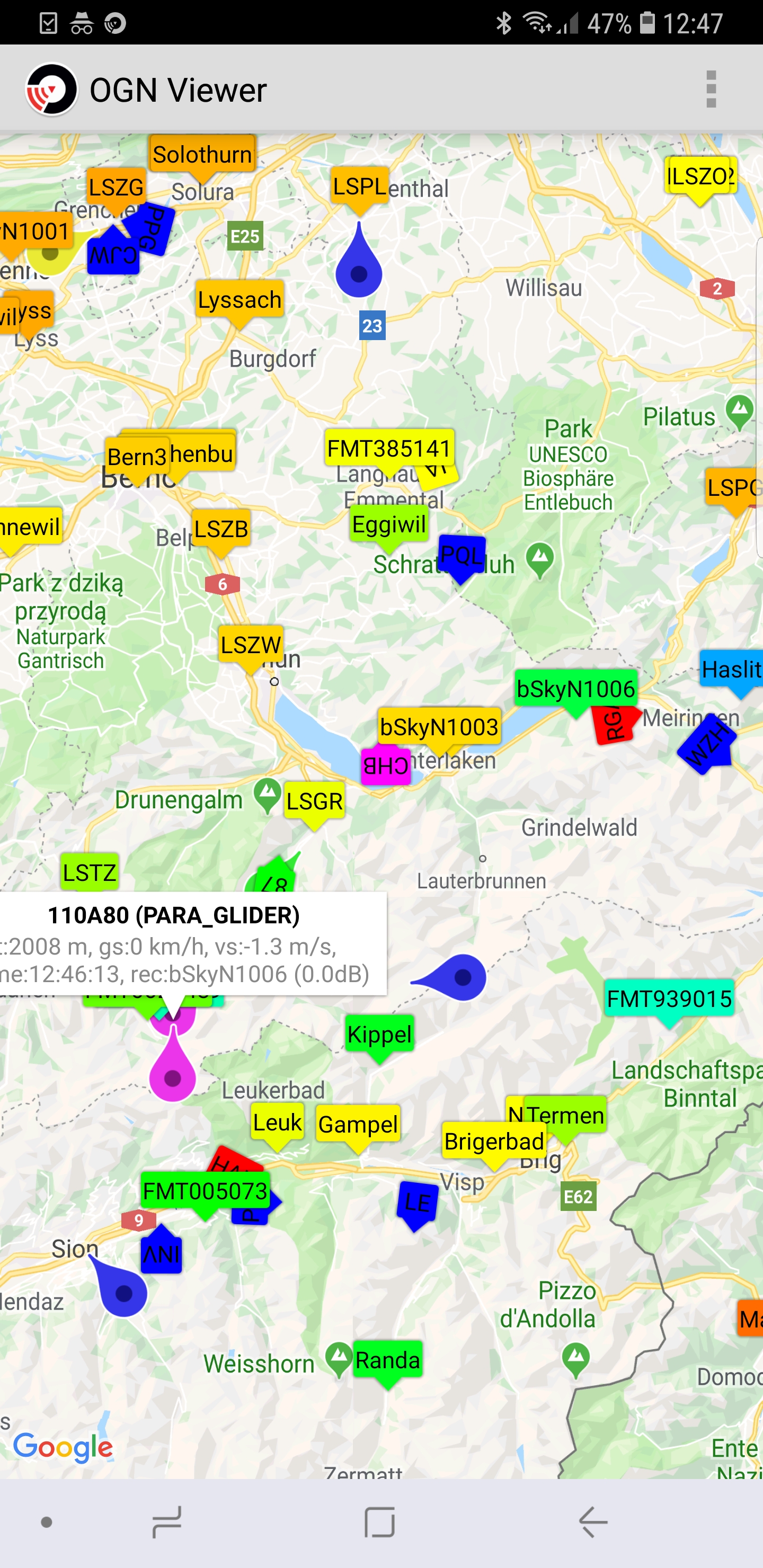

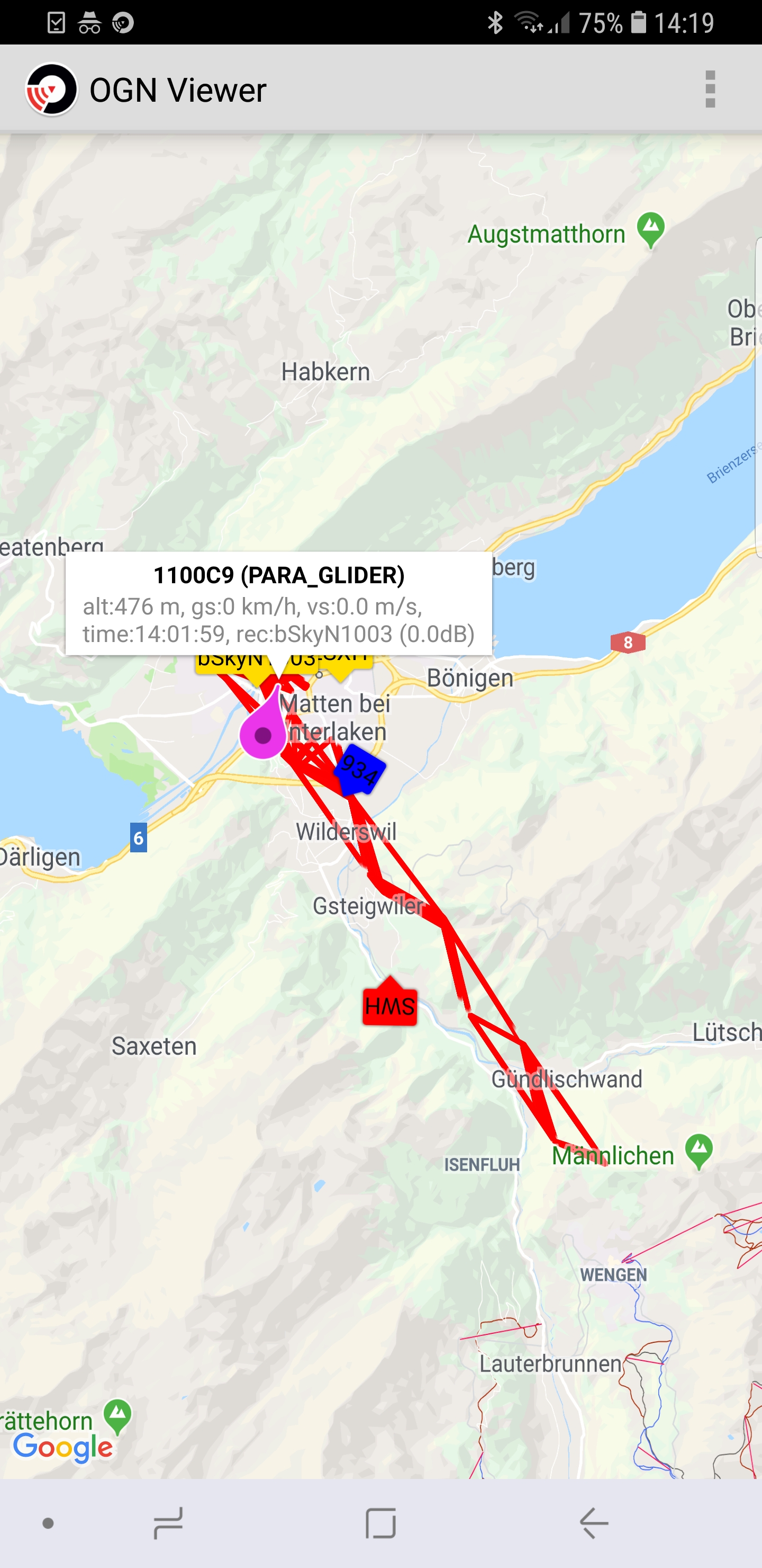

Here are screenshots from free arduino application that show our stations and pilots transmiting over it. First image shows flight path, and second shows distance of received pilot position information, and hard to believe it, about 50km from pilot to ground station.
