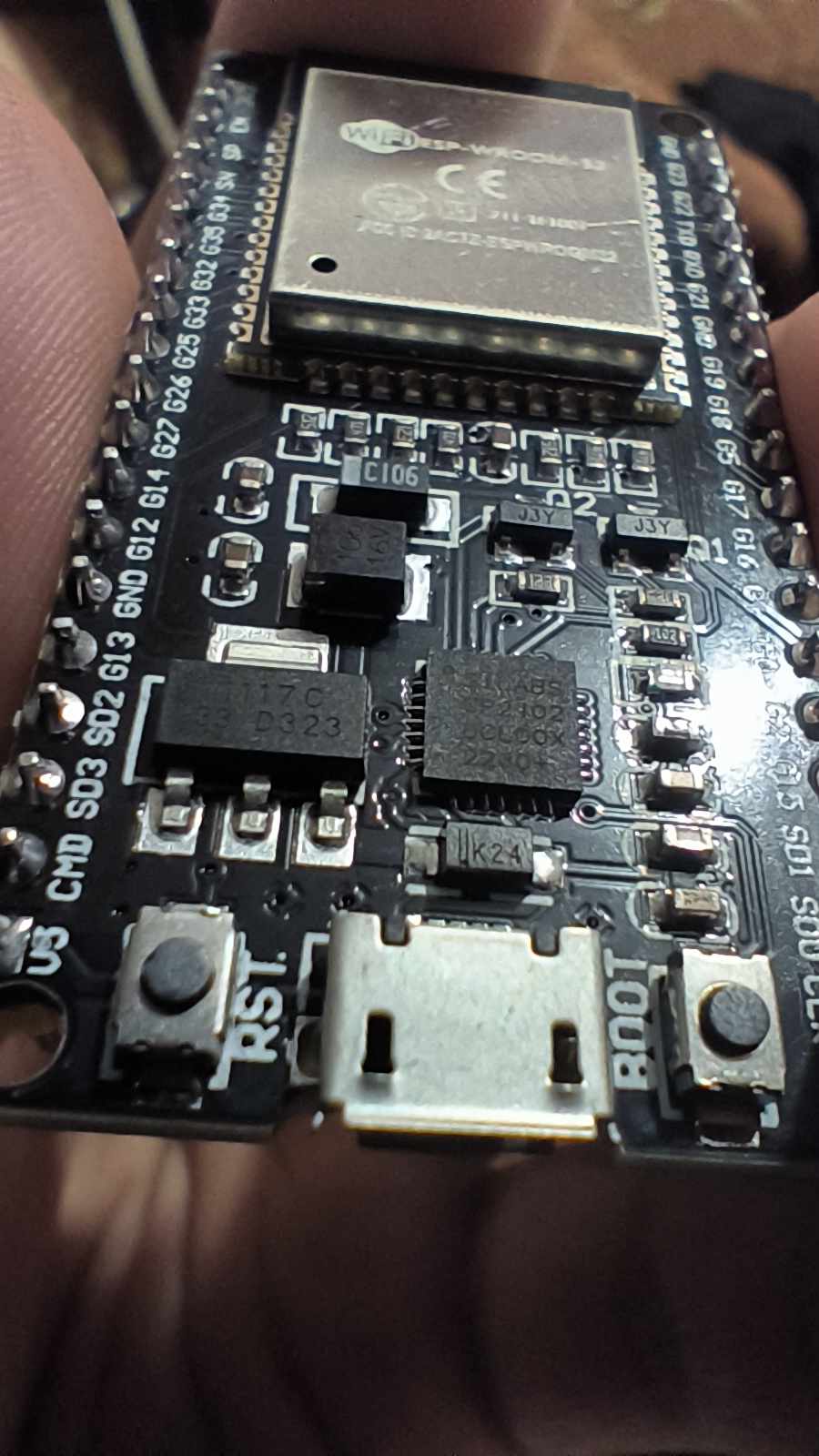

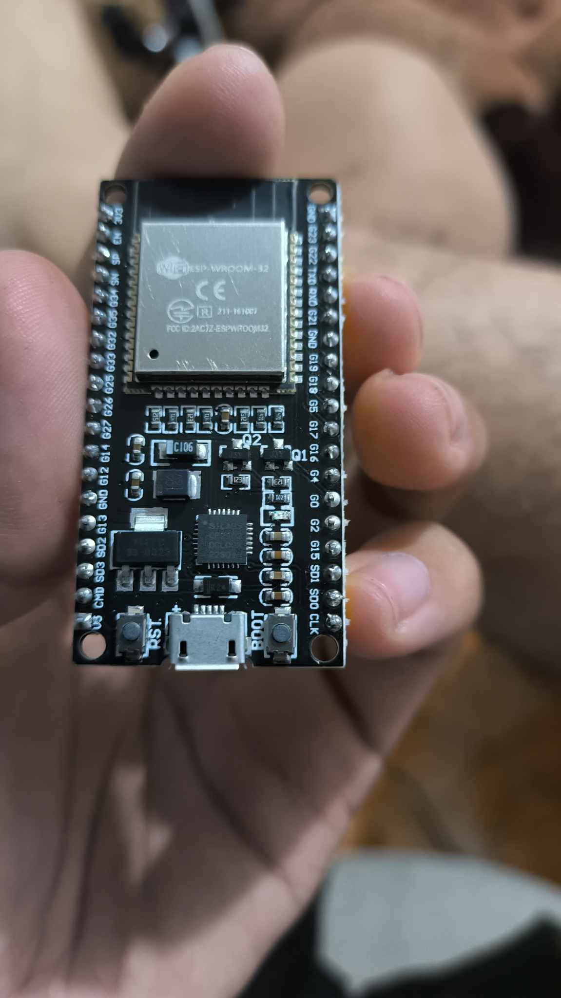

I have a similar problem. I ordered an ESP32, 38 pin on Shopee. I tried uploading a black sketch just the void setup and void loop. The indicator light is not responding but I can hear and see that it has been connected to the laptop. The are a lot of diode in the module, how do I know what to remove and solder?
