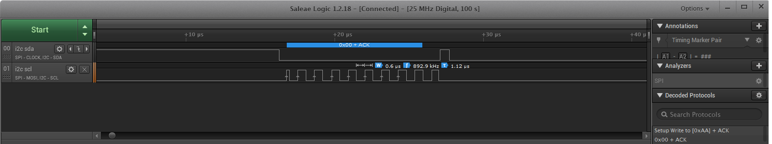

I have some problems with I²2 when I communicating with a battery gauge-IC BQ35100. I am using a ESP-Wroom-32D with ESP-IDF 3.2
If I set the I²2 clock frequency to 100KHz or 400KHz I will get I²C timeouts all the time when reading.
What I have seen is that the clock is not consistent and varies during a single byte transfer and it does not look like a slave clock stretch. The application is only doing this and i have also tried running the I²C communication in a separate task on different cores.

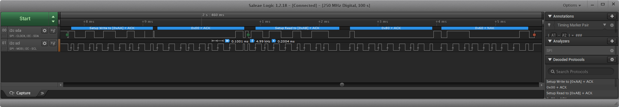

Here is a recording with a logic analyzer with 100KHz clock. The marking circle to the right shows a strange behavior. The clock is 893KHz! See the the zoomed in picture below.
If I use 10KHz as I²C clock it work most of the time.
External pull-ups is used. Tried with both 10K and 2.2KOhm. Henceforth I will use 2.2KOhm because the BQ35100 requires maximum rise time of 300ns.

It seems that your I2C bus is broken. When the driver detects a timeout event, it clears the I2C bus. Also, your IDF version is a bit old, we updated the I2C driver 1 month ago, please try the latest version. By the way, I want to know the following informations:
1. If the hardware filter of I2C is enabled? if not, the latest version have enabled this feature by default, you can have a try.
2. How many slaves are in you I2C bus?
3. Whether there is a 3.3v - 5V level matching circuit?
4. Whether there is a large capacitance on the I2C bus?
thanks !!

Thanks for your reply!
1. What version of IDF do you prefer? Isn't the 3.2 version the latest released? Commit: bed50a93f
2. Only one!
3. All circuits use 3.3V
4. No capacitors, The IC is connected directly to the ESP (3cm apart) with pull-ups .

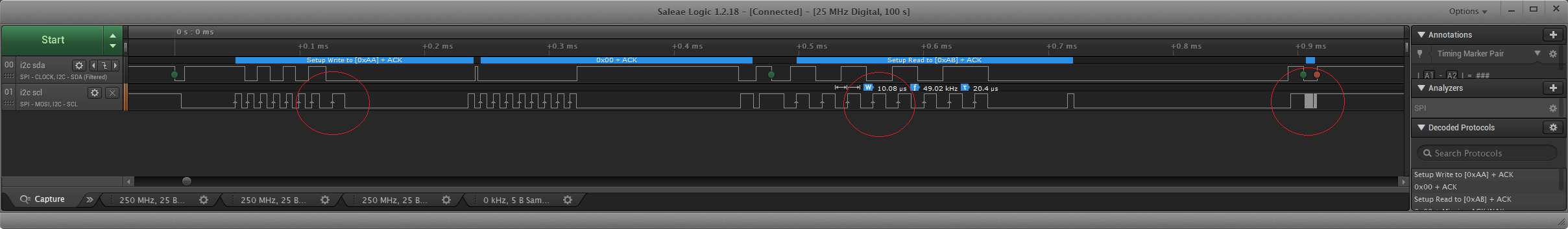

I have now tested with the master branch but with similar results. See recording below.
i2c 100kHz master branch.png (89.54 KiB) Viewed 13969 times
And when changing the I²C clock frequency to 10KHz its working. see recording below.
i2c 10kHz master branch.png (82.99 KiB) Viewed 13969 times
Thanks in advance!

Hi, @persan666
Thanks for you feedback, from the picture we know that the timing is abnormal. Can you help with another test?
in i2c.c, please find the function ` i2c_master_clear_bus` and change it to:
static esp_err_t i2c_master_clear_bus(i2c_port_t i2c_num)
return ESP_OK;
I want to know if the clock is stable, thanks !!

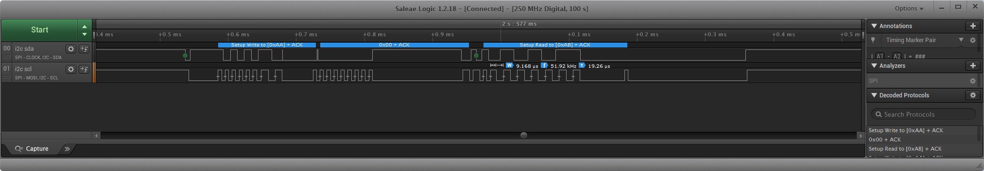

return ESP_OK;
Thank you for your reply!
I have done some recordings with the suggested change. See below
10KHz (still working)
i2c_master_clear_bus changed 10KHz.png (81.71 KiB) Viewed 13876 times
100KHz (not working)
i2c_master_clear_bus changed 100KHz.png (73.74 KiB) Viewed 13876 times

Why the SCL frequency changes during data transmission? :?:
wookooho
persan666
Posts: 28
Joined: Fri Feb 16, 2018 9:17 am
Re: I²C clock problem
Postby persan666 » Thu Jan 24, 2019 3:26 pm
ESP_houwenxiang wrote:
Thu Jan 24, 2019 11:39 am
I also wonders why this is so. It could not be the slave that doing clock stretching because then the positive clock level should be shorter than the low level?
