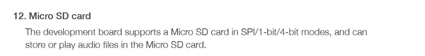

Hi everyone,
How can we sing a song from micro sd card?
• What is the commnad for play a tune from microsd card.
• Can we setup a media player to kit. If your answer is yes, How can we find player.exe and how to install it?
• For instance, Let say we have two tunes as A.mp3 and B.mp3 on SD card. I want to play A.mp3 , what can I command to the board for playing A.mp3?
In the datasheet of MSC, They indicate tune can be played on SDcard.
I add the datasheet SS.
Please help me.

I think you can refer to the "cli" example.
/esp-adf/examples/cli
The "cli" sample code don't support ESP32-LyraTD currently.
But you can refer to esp-adf/examples/get-started/play_mp3 and porting the ZL38063 and replace the ES8388.
https://github.com/espressif/esp-adf/tr ... amples/cli
