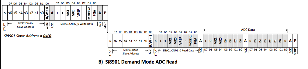

I'm trying to communicate with a Si8901 I2C ADC IC.
From the documentation, this is the I2C protocol:
Screen Shot 2018-09-07 at 1.05.25 PM.png (59.55 KiB) Viewed 2857 times

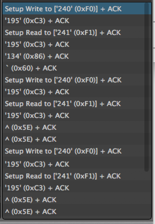

The value of ADC_VALUE_1 is correct, 0xC3. The value us ADC_VALUE_2 and ADC_VALUE_3 is wrong. After the first iteration or reads, the values are alway different. With every read, I get the ESP_ERR_TIMEOUT error. I used a saleae logic analyzer to get a closer look at what is happening. Below I have those screen shots.
Screen Shot 2018-09-07 at 2.01.28 PM.png (85.54 KiB) Viewed 2857 times
The protocol should be
Master Start
Master write address 0xF0 with write bit and ACK
Master write config byte with ACK (Config byte is 0xC3)
Master Stop
Master Start
Master write address 0xF0 with read bit and ACK
Slave Start
Master Read with ACK
Master Stop
I'm not sure what the issue is. The third i2c_master_read_byte looks different on the logic analyzer than the other i2c_master_read_byte reads on the first iteration.
