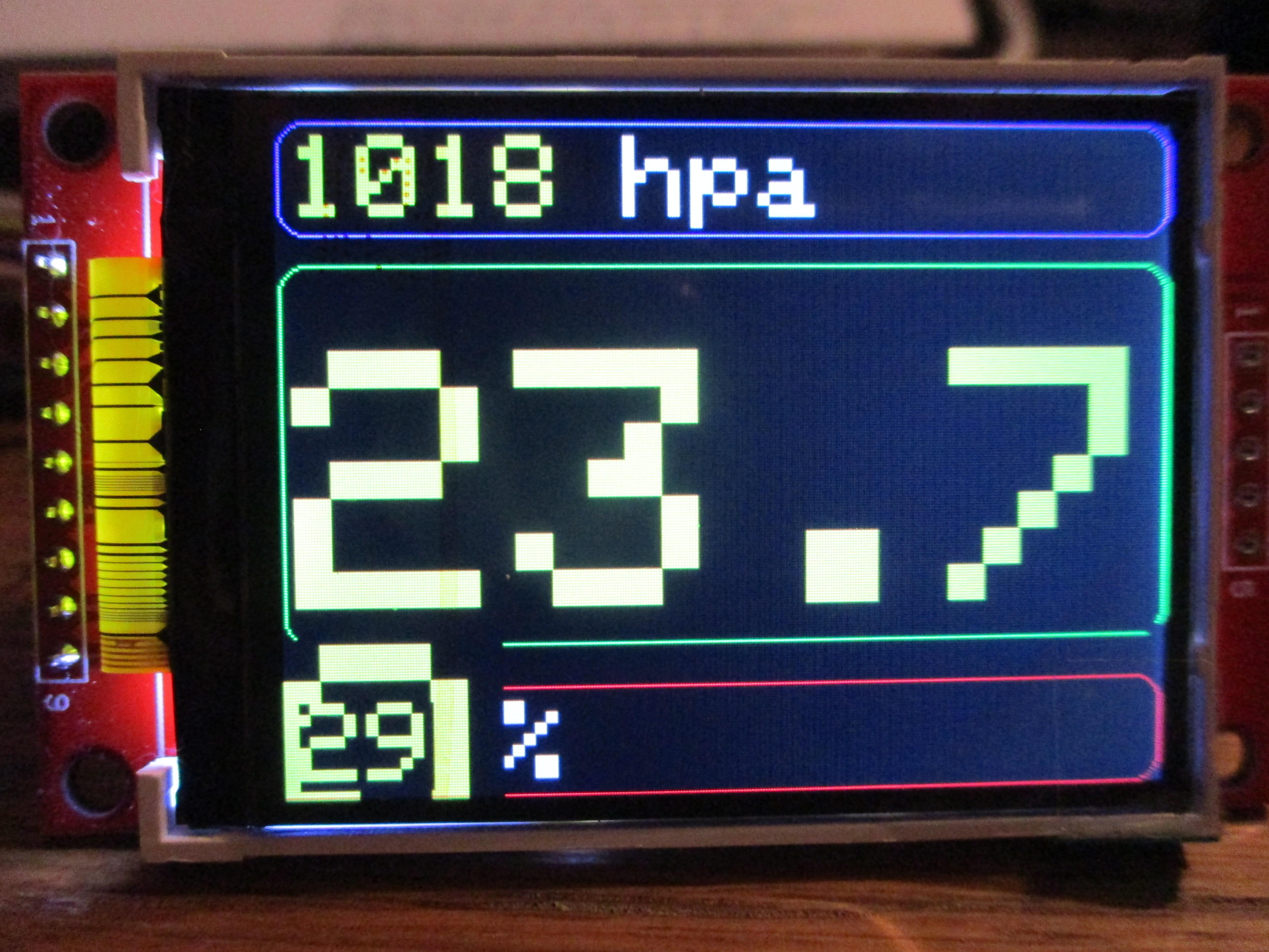

Hello Archibald,
I implemented your code and it works - of course. My webserver now sends "1017,23.8,28".
But there is one strange phenomenon
The value "humidity" has a strange "frame" now that wasn´t there before.
BTW: Excuse me for all those questions and misunderstandings - I´m good at hardware but I´m relatively new to C

Re: Separate Values from a String
I think you included an out of date version of your code; otherwise I would have expected a comma or two to show up on the display!
Because the number of characters representing each value can vary, you need to print the integer and float values to the display, not the substrings. Also, because the number of characters varies and the width of characters varies, I would expect you to have to clear an area of display before printing each new value to the display.
Regarding the 'framing', sorry I don't know anything about that display and its library. It may be best to start a new forum thread for that.
By the way: "hpa" should be "hPa" .
You can delete the console Serial.print statements (unless you want them for debugging).

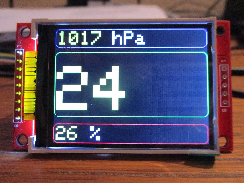

UPDATE!!!!!
When I declare "int temperature" instead of "float temperature" the phenomenon does not appear - see picture!!!
