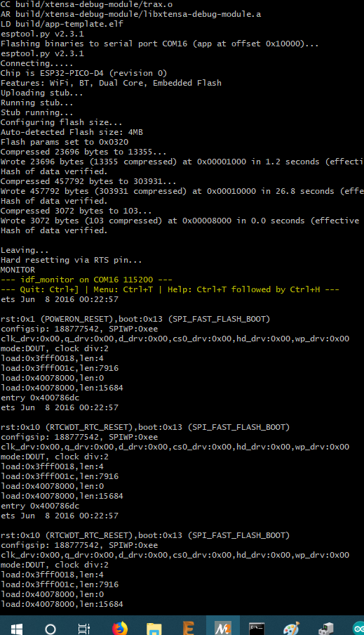

I have a custom board with the ESP32-PICO-D4 , I can program it but it gets stuck into a boot loop.
I tried changing all the modes and changing the SPI bus speed. Still the same issue.
The board is based on the PICO-D4 reference design. I have left out the pull-up on IO12 to enable 3V3 operation.
I also dumped the fuses and I see that the SPI pins are already set.
I tried programming with both the Arduino IDE and the IDF and still the same issue.
Any suggestions would be appreciated.
I tried searching on the forum for any solutions but I don't see any fix.
esptool.py v2.3.1
Flashing binaries to serial port COM16 (app at offset 0x10000)...
esptool.py v2.3.1
Connecting.....
Chip is ESP32-PICO-D4 (revision 0)
Features: WiFi, BT, Dual Core, Embedded Flash
Uploading stub...
Running stub...
Stub running...
Configuring flash size...
Auto-detected Flash size: 4MB
Flash params set to 0x0320
Compressed 23696 bytes to 13355...
Wrote 23696 bytes (13355 compressed) at 0x00001000 in 1.2 seconds (effective 161.8 kbit/s)...
Hash of data verified.
Compressed 457792 bytes to 303931...
Wrote 457792 bytes (303931 compressed) at 0x00010000 in 26.8 seconds (effective 136.7 kbit/s)...
Compressed 3072 bytes to 103...
Wrote 3072 bytes (103 compressed) at 0x00008000 in 0.0 seconds (effective 786.6 kbit/s)...
Leaving...
Hard resetting via RTS pin...
MONITOR
--- idf_monitor on COM16 115200 ---
ets Jun  8 2016 00:22:57
configsip: 188777542, SPIWP:0xee
mode:DOUT, clock div:2
load:0x3fff0018,len:4
load:0x3fff001c,len:7916
load:0x40078000,len:0
load:0x40078000,len:15684
entry 0x400786dc
entry 0x400786dc
entry 0x400786dc

Could you please set bootloader log level to "Verbose" and give it a try? It looks like SPI flash is okay and 2nd stage bootloader gets loaded, but crashes for some reason. Maybe log output will have some extra info.

It's already set to verbose but nothing gets printed so I'm just wondering how can this be.
The only thing that is different from other ESP chipsets is that SPIWP is set to 0xee. and configsip is not 0x00.
