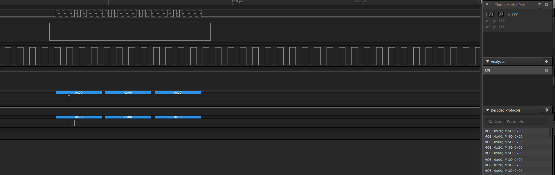

hello,
i really need your help with the implementation of the AFE4300 chip.
Currently I only got the two values 0 or 65536, I suspected the error was in the SPI communication but I am not sure. The following code was ported from the Arduino community.
Datesheet: http://www.ti.com/lit/ds/symlink/afe4300.pdf
The first question is: do I have to set the CS pin independently?

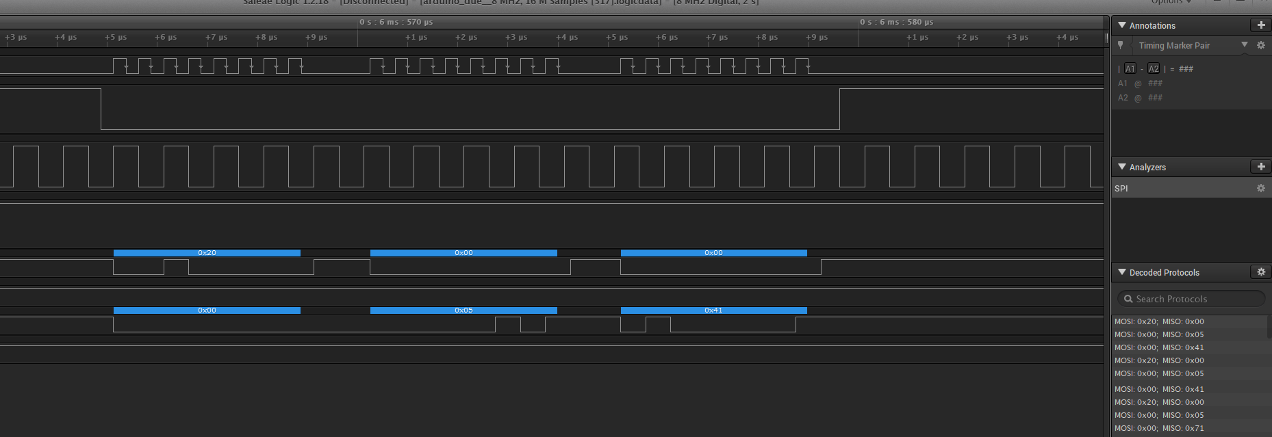

Thanks for the feedback!
With the Arduino Framework i think i get "correct" values
But with the esp-idf framework i only see that im sending the command byte (0x20) and two data bytes (0x00) but there is nothing shifted inside miso.
What falls into place is that
- MOSI is low and with Arduino it is high in default state
- transfering with the Arduino Due i see that the clock is for a short time paused between each byte
does anyone have a tip on how I could get this to work with the esp-idf?
I tried the with the spi_master API and currently i try that with the "spi_master" from loboris but actualy without luck.

Postby f.h-f.s. » Tue Jun 26, 2018 7:32 am
What I am noticing is that your command bytes are sent right after each other. Try adding a delay in between them? See page 22 of that datasheet, it states you need to have a delay of 8us in between your commands. It actually tells you exactly how the signal should look.
Goodluck!

Thanks for the response.
Yes thats right and i tried to transfer byte by byte without luck.
Pseudo code:
set cs: low
1 to 3:
	create and fill transaction with 1 byte
	result = transfer transaction
set cs: high
So may i ask how to achieve a short delay between a transaction?
device_interface_config_t.pre_cb // to soon
device_interface_config_t.post_cb // to late
device_interface_config_t.input_delay_ns // could this help???
device_interface_config_t.cs_ena_posttrans // talks about the cs line
One thing i could try is to modify the spi_master library from loboris.
Maybe something like this:
// ** Start the transaction ***
host->hw->cmd.usr=1;
// Wait the transaction to finish
while (host->hw->cmd.usr);
delayMicroseconds(8);

Postby f.h-f.s. » Tue Jun 26, 2018 10:58 am
The RDY signal asserts when a byte is received and de-asserts when a byte has been processed. Can you show me what this signal is doing in the case of arduino and esp-idf?
In each case watch the signals STE(CS),SCLK(CLK),SDIN(MOSI),SDOUT(MISO), RDY, RST.
I would like to see the signal from startup up to and including the first transaction. Maybe the arduino driver for the AFE4300 resets the device properly(see page 20 of the datasheet)?

Ok i will prepare my two projects (arduino / esp) later and capture the results.

Postby OneTwo » Tue Jun 26, 2018 6:02 pm
The capture are made with Sale Logic Application (file extension: logicdata)
esp32_byte_by_byte.txt
(8.24 MiB) Downloaded 1079 times
use loboris SPI
esp32_24bits_transfer.txt
(8.92 MiB) Downloaded 1098 times
use loboris SPI
esp32_24bits_transfer_no_lobo.txt
(10.63 MiB) Downloaded 1016 times
not used

Postby f.h-f.s. » Tue Jun 26, 2018 9:28 pm
I'm missing the logicdata for the arduino project(miso always 0 in these files), and missing the RST pin(although the code looks good for resetting).
I also noticed SCLK is at 2mhz, but your code does specify 1mhz for the clock frequency. Can you try halving 1mhz to 500khz?
What I said about the RDY pin asserting and de-asserting is only true if you have it in one-shot or continuous mode.
