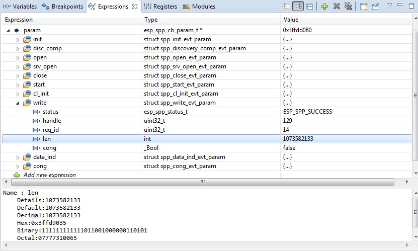

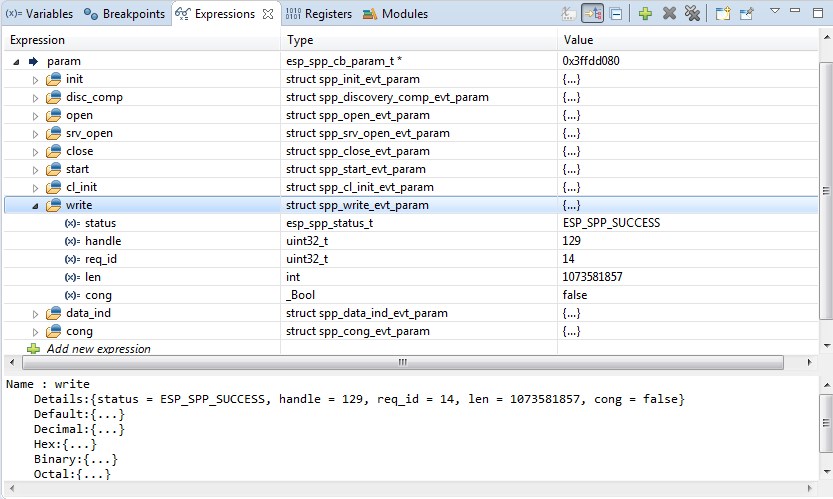

Under debugging breakpoint at esp_spp_write in callback esp_spp_cb:
     case ESP_SPP_DATA_IND_EVT:
        ESP_LOGI(SPP_TAG, "ESP_SPP_DATA_IND_EVT len=%d handle=%d", param->data_ind.len, param->data_ind.handle);
        if (param->data_ind.len < 1023)
            if(MyData.UART_got_packet == true)
               esp_spp_write(param->write.handle, MyData.UART_len, MyData.UART_buffer);
               MyData.UART_got_packet = false;
This param looks like this:
I tried to set it 129, but I dont receive any data in spp.
chegewara
Posts: 2444
Re: UART to SPP bridge: how to send data from UART to SPP?
Postby chegewara » Thu Apr 26, 2018 11:06 am
handle is uint32_t type:
https://github.com/espressif/esp-idf/bl ... .h#L95-L99
but what is interesting its the len value, i dont think it should be as high, it looks more like address or wrong value.
newsettler_AI
Posts: 121
Joined: Wed Apr 05, 2017 12:49 pm
Postby newsettler_AI » Thu Apr 26, 2018 11:25 am
chegewara wrote:handle is uint32_t type:
Yes, this is address.
chegewara
Posts: 2444
Postby chegewara » Thu Apr 26, 2018 11:30 am
Why? It should be int type, not int*:
https://github.com/espressif/esp-idf/bl ... api.c#L153
newsettler_AI
Posts: 121
Postby newsettler_AI » Thu Apr 26, 2018 11:53 am
chegewara wrote:Why? It should be int type, not int*:
Yes and it is uint32, but in debugger I'm looking at param which comes as address.
In debug log (under CASE in cb section) this looks like this:
SPP_RS485: ESP_SPP_DATA_IND_EVT len=14 handle=129

chegewara
Posts: 2444
Postby chegewara » Thu Apr 26, 2018 12:00 pm
param is type of union esp_spp_cb_param_t:
https://github.com/espressif/esp-idf/bl ... api.h#L168
For this particular event it will be this structure:
https://github.com/espressif/esp-idf/bl ... #L150-L158
I think this ( my_param.write.handle = ???; // 129 ?) should be somewhere in here:

newsettler_AI
Posts: 121
Postby newsettler_AI » Thu Apr 26, 2018 2:11 pm
I have managed this route UART -> SPP! :P
As Markus said, I'm keeping handle for connection and then transferring it to my functions.
And as chegewara noted about unions, I have remake my function for transferring handle, len&buffers (I'm pretty sure there was some mistake).
Thanks you both! :)
