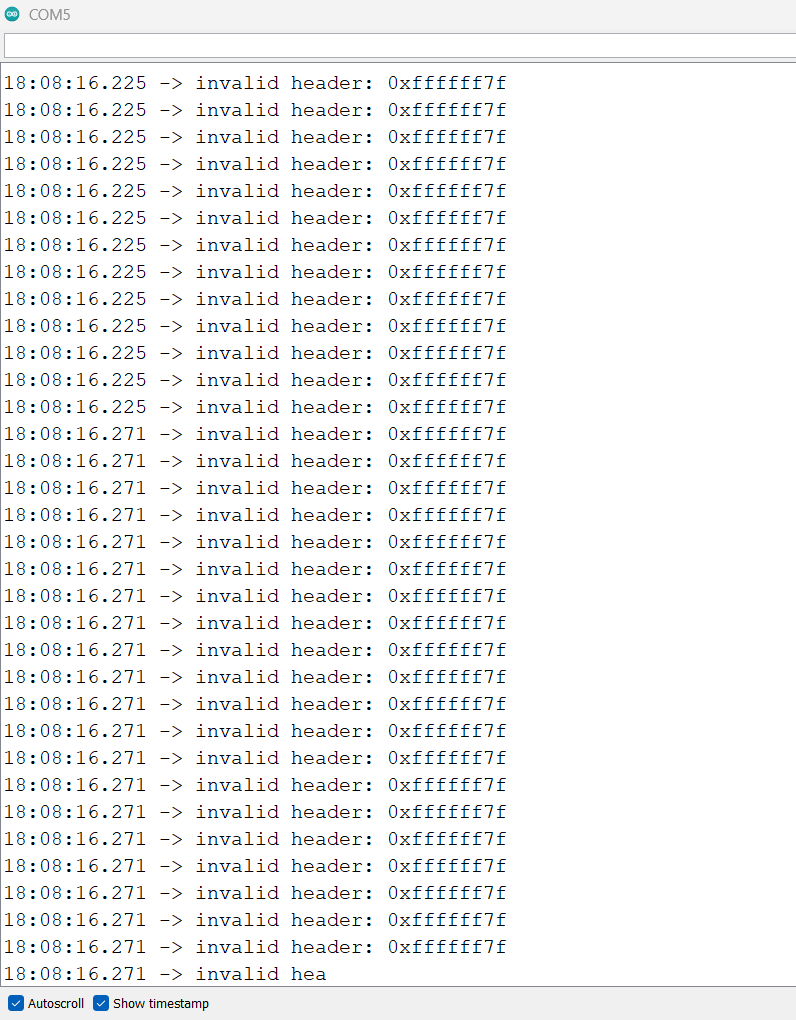

I know that USB communication is OK, since I can connect to the board and I get the following:
Captura de pantalla 2025-03-06 180826.png (83.08 KiB) Viewed 176 times
I may think that the problem is in the flash, since is the only thing I changed from previous desings and it seems to be freezing when it tries to access the flash.

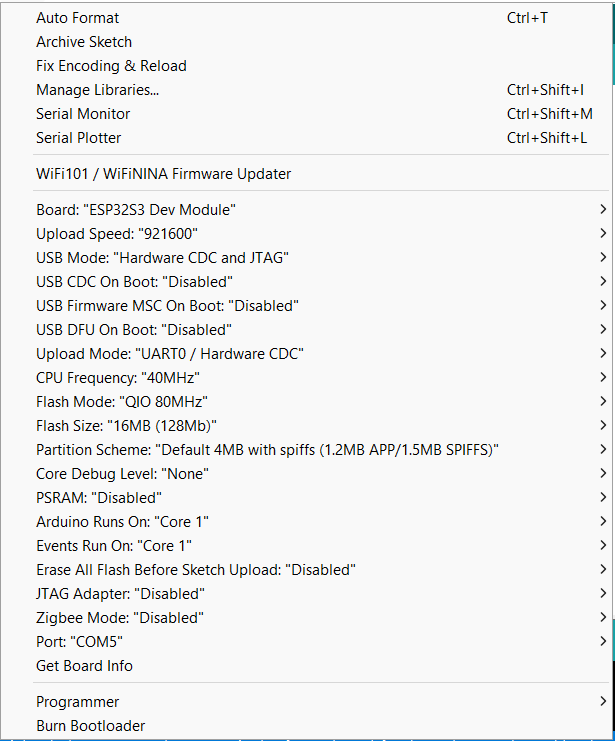

And finally, here all the configurations I am using to upload the (empty) sketch:
Sin título.png (33.92 KiB) Viewed 176 times
Do you have any advice on where should the error be?
