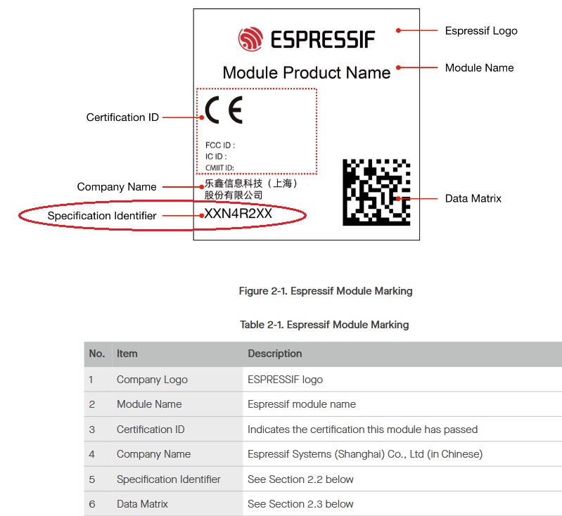

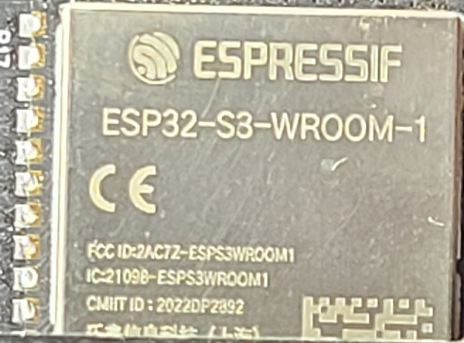

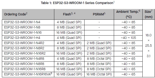

How can I tell which ESP32-S3-WROOM-1 module I have?
ESP32 MOdule table.jpg (108.37 KiB) Viewed 2276 times
There is no identification on the module:

Postby ahsrabrifat » Fri Feb 14, 2025 6:08 am
From the outlook, there is no way to figure out the version. I think you need to check the sizes of flash and PSRAAM with software.
https://docs.espressif.com/projects/esp ... psram.html
https://esp32.com/viewtopic.php?t=4086

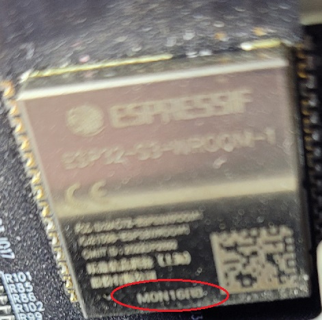

Postby klaatu2 » Fri Feb 14, 2025 5:22 pm
The version is printed on the module. (see images below)
THe module shows N16R8 = 16MB Flash, 8MB PSRAM.
But I still need a way for software to identify...or rather confirm the correct module has been loaded
ESP32 MOdule ID.jpg (109 KiB) Viewed 1554 times
lbernstone
Posts: 916
Re: Module version??
Postby lbernstone » Sun Feb 16, 2025 9:45 pm
Use any sketch you like (simpler is better). Open the serial monitor in Arduino IDE. Choose OPI PSRAM and Core Debug Level Verbose in the board menu. Upload the code. If you choose the wrong type of psram, it will boot loop. If you choose the right type of psram, you will be able to see the amount of SPIRAM (aka psram) listed near the end of the report.
