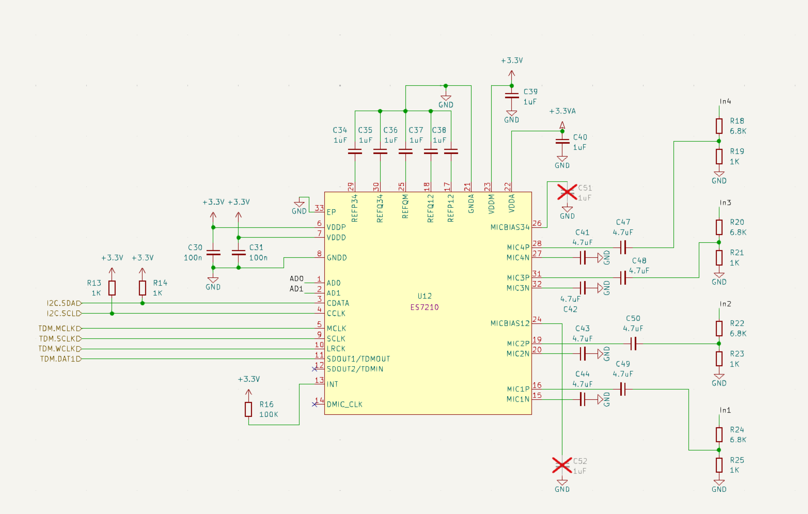

Here is my ES7210 schematic(from the ESP32-S3-Korvo, except for RC filters on the data lines, but they are only about 30mm long, so it shouldn't matter, I guess.)
Schematics
Untitled (1).png (448.47 KiB) Viewed 1694 times

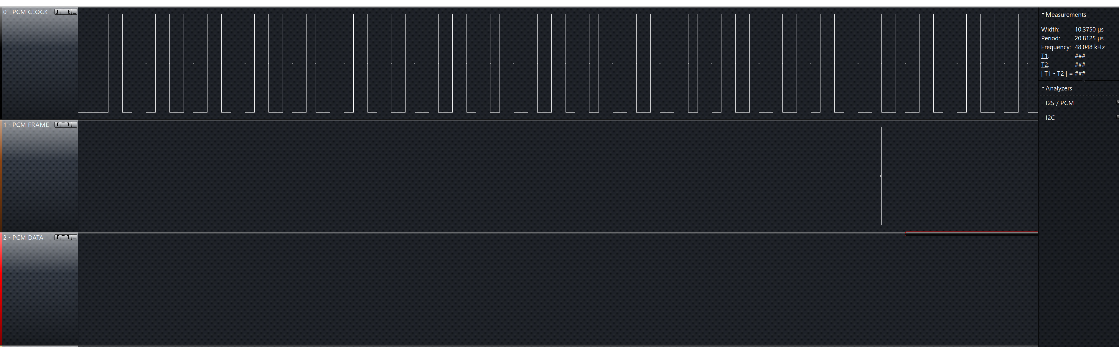

And the waveforms from the logic analyzer on the I2S bus
I2S waveforms

It has absolutely nothing on the SDOUT1 pin(SDOUT2 is floating, MCLK has a 12.288MHz clock, and AD0, AD1 are connected to GND via a 10K resistor). I feed a 100Hz 1 Volt AC signal into the ES7210 inputs. Nothing is shorted and everything is connected. All the power supply voltages are fine. I couldn't download the ES7210 user manual. I'm just crying with no idea what's next to check and asking people on this forum to advise what else can be checked.
Thank you in advance.
payday1991
Joined: Thu Apr 04, 2024 11:36 am
Re: ES7210. All signals are fine, but nothing on SDOUT1 pin.
Postby payday1991 » Sat Feb 15, 2025 2:09 am
I found the reason. It was an error in my schematics outside the schematics in this post. Please delete the post. Thank you. :roll:
