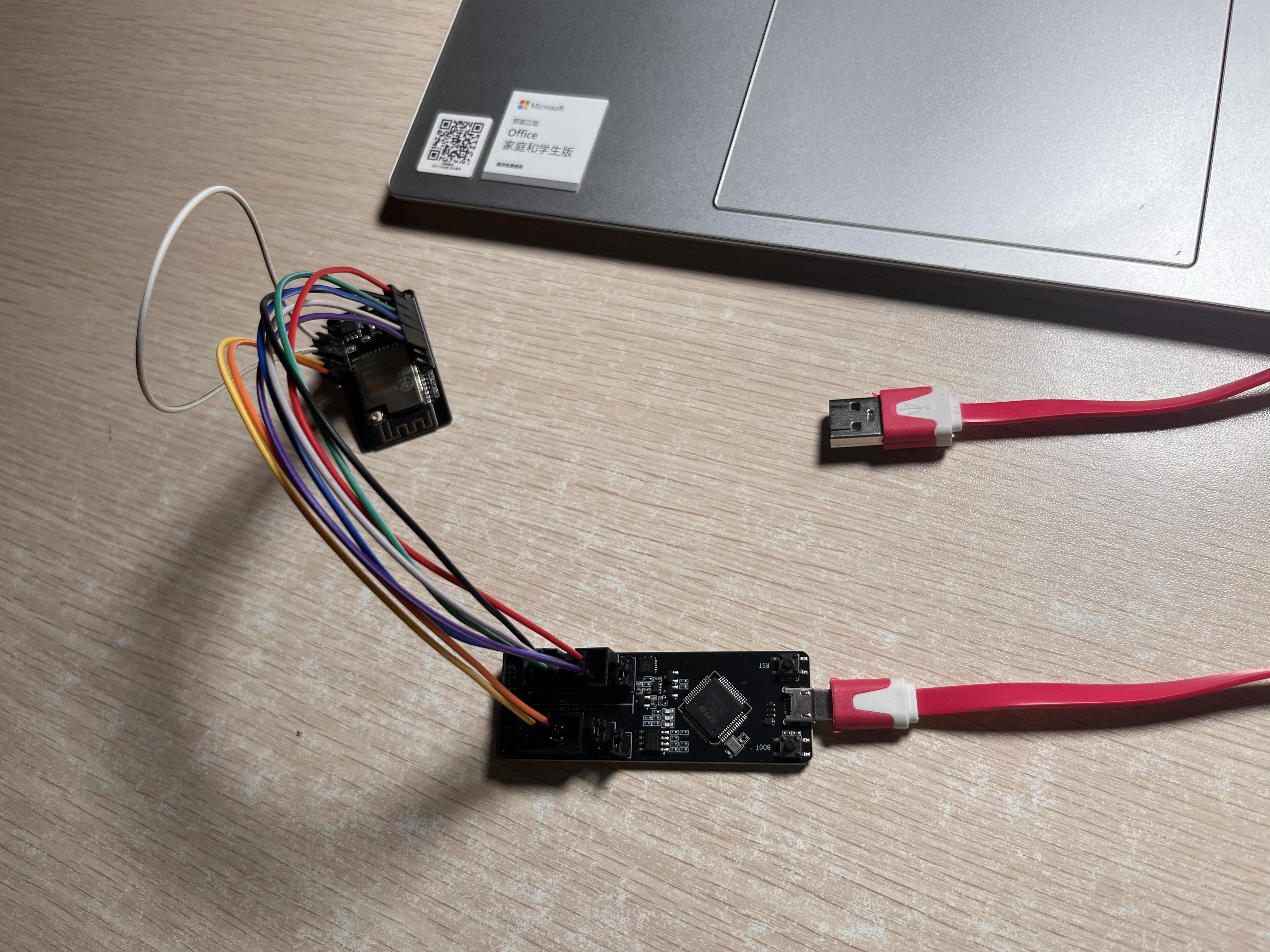

Postby bluesman » Thu Oct 17, 2024 5:35 am
WIN环境下,esp-idf5版本,目标板esp32cam,通过ESP-PROG上传和调试,见附件,接线应该没有问题,我在配置JTAG卡时,openocd -f interface/ftdi/esp32_devkitj_v1.cfg -f target/esp32.cfg, 有时正常,但是大部分时间都是下面几种错误信息,不知道是怎么回事,换了个ESPPROG也是这样:
一、正常情况:
adapter speed: 20000 kHz
Info : ftdi: if you experience problems at higher adapter clocks, try the command "ftdi tdo_sample_edge falling"
Info : clock speed 20000 kHz
Warn : [esp32.cpu1] Unexpected OCD_ID = 00000000
Warn : target esp32.cpu1 examination failed
Info : starting gdb server for esp32.cpu0 on 3333
Info : [esp32.cpu0] Debug controller was reset.
Info : [esp32.cpu0] Core was reset.
Info : [esp32.cpu0] Target halted, PC=0x40009081, debug_reason=00000000
Info : [esp32.cpu0] Reset cause (1) - (Power on reset)
Info : [esp32.cpu0] Target halted, PC=0x40079EBA, debug_reason=00000000
Info : [esp32.cpu1] Debug controller was reset.
Info : [esp32.cpu1] Core was reset.
Info : [esp32.cpu1] Target halted, PC=0x400F1FFE, debug_reason=00000000
Info : [esp32.cpu1] Reset cause (14) - (CPU1 reset by CPU0)
二、CPU1
Open On-Chip Debugger v0.12.0-esp32-20230419 (2023-04-18-22:02)
Licensed under GNU GPL v2
For bug reports, read
Info : [esp32.cpu0] Target halted, PC=0x40008744, debug_reason=00000000
三、all ones
Error: esp32.cpu0: IR capture error; saw 0x1f not 0x01
Warn : [esp32.cpu0] Unexpected OCD_ID = ffffffff
Warn : target esp32.cpu0 examination failed
Warn : [esp32.cpu1] Unexpected OCD_ID = ffffffff
我刚学习不久,这问题搞的我头大了,有谁能指点下吗?
