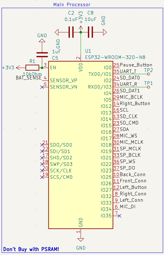

Hey Everyone! I have a little weird situation with one of my recent projects. I've only worked with the ESP32-WROOM-32 module once before, but I've used the ESP32-S3 module multiple times. My recent design looks like this:

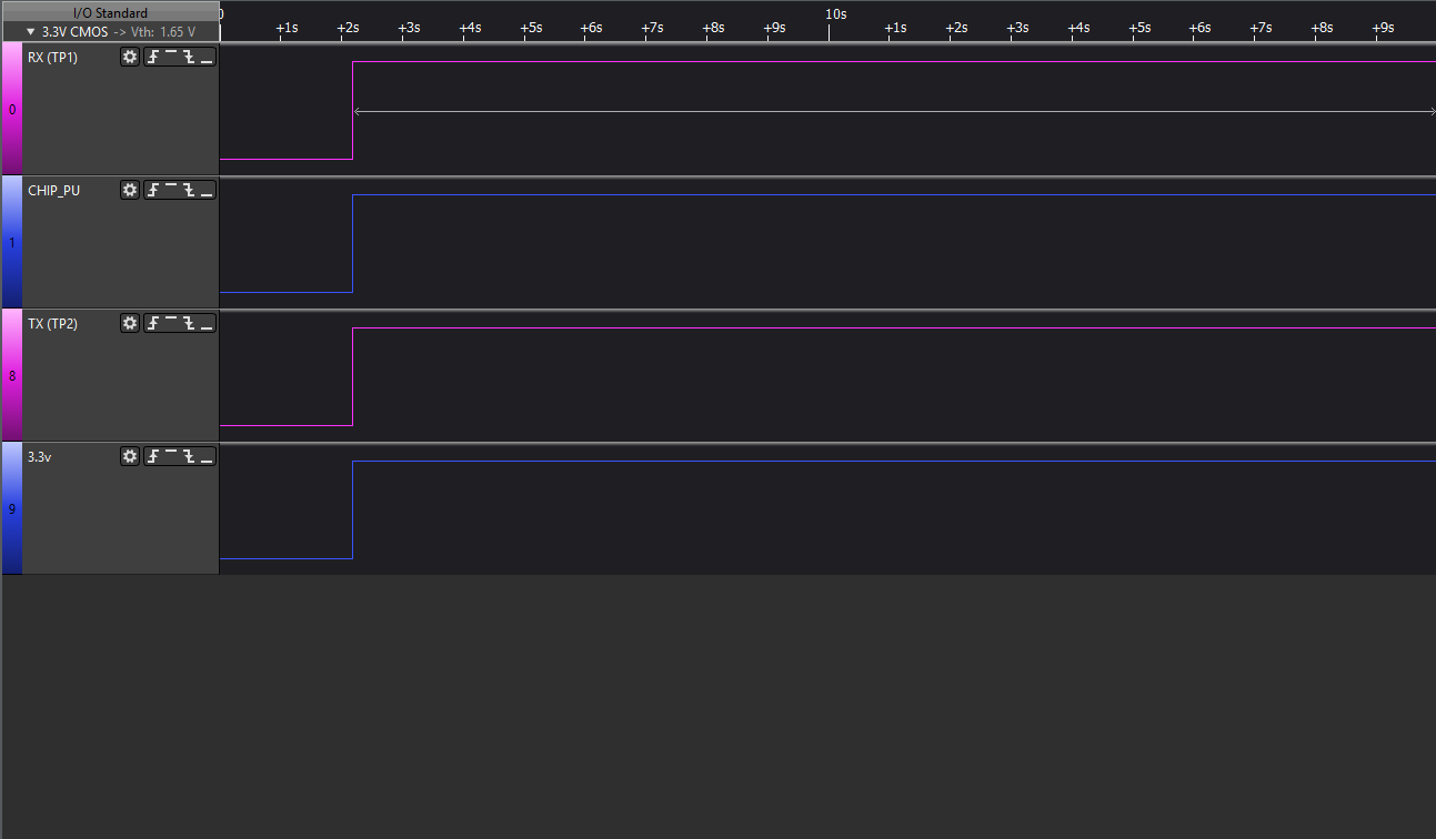

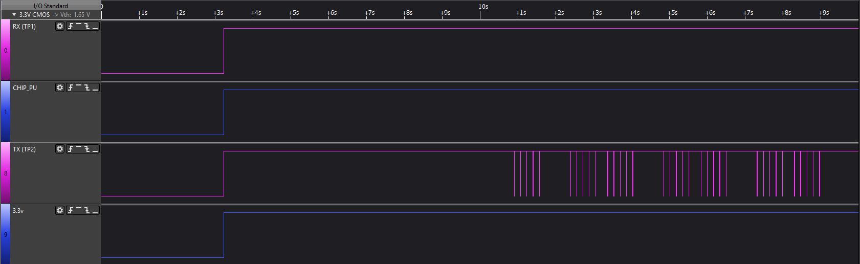

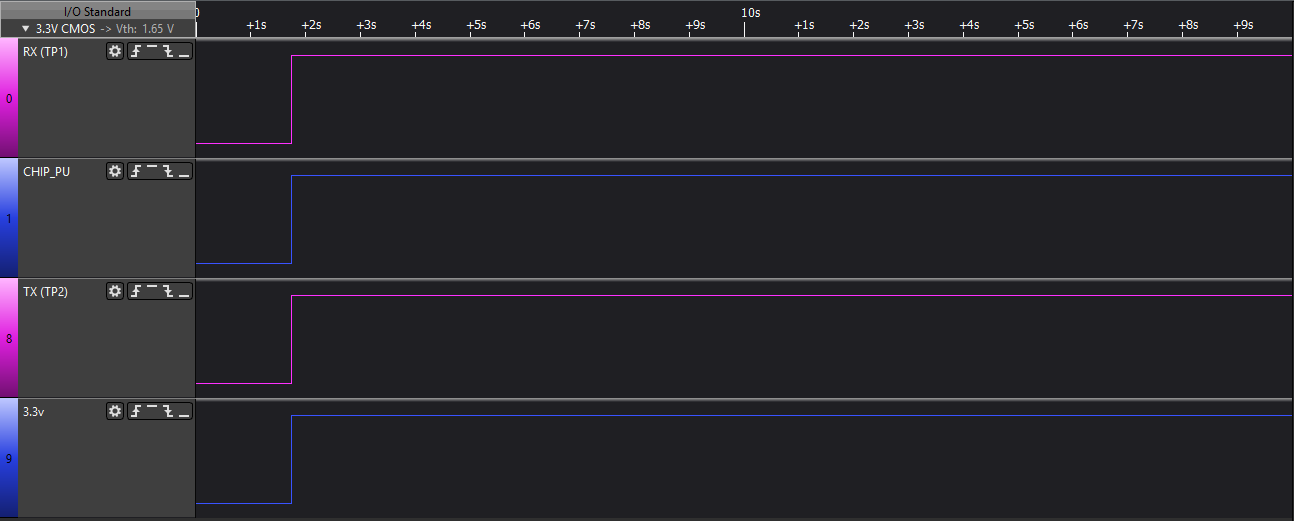

Here's the analyser with IO0 low, but no ESP-IDF: Here's the analyser with IO0 high: Here's the analyser with IO0 low, but with ESP-IDF trying to connect: Huh, I guess the RX and TX's got screwed up... Maybe I should try to have boot set, with ESP-IDF trying to flash and swap the rx and tx pins using an external converter? Doesn't seem likely since esp32s usually have some output on IO0 low, with no ESP-IDF interaction. Unless the esp32 is different.

The power supply is A-ok, yet I'm not sure about the CHIP-PU input. As the schematic reads, I put down 10k ohms and 1uf, as the datasheet suggests, and my multimeter reads 10k for the resistor, but I don't know how to read the capacitor with a multimeter. I'm pretty sure I soldered a 1uf but I could just be insane. I may just remove the cap and replace it to be sure. What do you all think?
