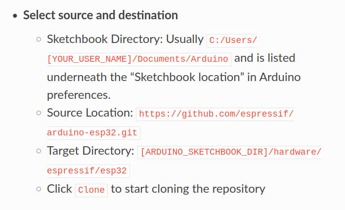

- Posts: 902
Re: Compiling ESP32-C2 Arduino lib
From manual installation instructions:
I cloned with git as it states in the docs, I make the c2 not hidden, I can see the new hardware directory show up in Arduino IDE.. however still get the error.
No such file or directory: 'C:\\Users\\Richard\\Documents\\Arduino\\hardware\\espressif\\esp32\\tools\\esp32-arduino-libs\\esp32c2\\bin\\bootloader_qio_60m.elf'
All ESPs are there in C:\Users\Richard\Documents\Arduino\hardware\espressif\esp32\tools\esp32-arduino-libs
see attached image
but no C2
R
see attached image
but no C2
R
- esp.png (4.42 KiB) Viewed 4311 times
