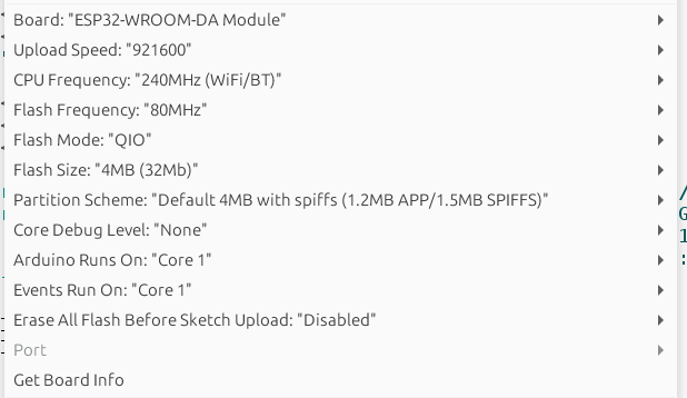

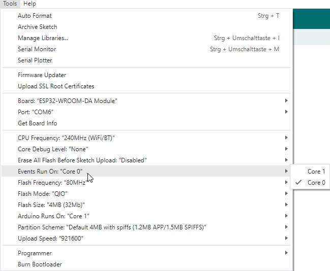

Hello all,
I'm trying to use my ESP32 (WROOM-DA) to control WS2812 and SK6812 led strips with the Neopixel library. I want to be able to control the animations etc via a web server, similar to projects like WLED. I program the ESP with the Arduino IDE.
Right now I essentially create two tasks, one for the webserver, and one for the color calculation and led programming loop. I pin the webserver task to core 0, since if I understand correctly, wifi tasks only run on core 0, or at least need core 0? The led loop I pin to core 1, which, unless the GPIO stuff is also managed by core 0, should work.
The whole thing works fine with both tasks running concurrently, but it fails if I press buttons on the website, therefore sending data to the web server. The led tasks completely halts for a good second before resuming. I thought if i ran both tasks on two different cores, I could avoid that and both tasks run concurrently? Why would it even halt for that long, it's not like there is a lot of data being sent?
Here is my cleaned up code. Note that the web server doesn't actually influence the led loop yet, this is just for testing, but that also means that IMO no multithreading issues like race conditions or whatever should be the problem.
Setup and the two task loops are at the bottom of the code, those are the most relevant, you can ignore all the led helper functions before that.

lbernstone
Posts: 903
Re: WiFi task on core 0 halts task on core 1
Postby lbernstone » Sat Sep 21, 2024 7:51 pm
Your task is running your code, not the whole tcpip stack. WiFi is running on the events core, which defaults to core1.

benskiskull
Posts: 5
Joined: Sat Sep 14, 2024 1:23 pm
Postby benskiskull » Sat Sep 21, 2024 8:25 pm
lbernstone wrote: Your task is running your code, not the whole tcpip stack. WiFi is running on the events core, which defaults to core1.
That's what I thought, therefore I set it to core 0, as I said in the end of my last reply. Maybe that doesn't work, but I don't see any reason why.
