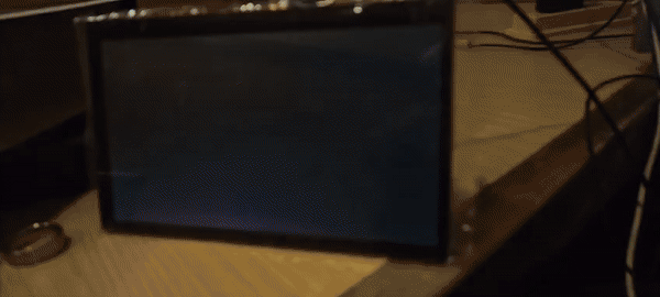

Hello chegwara,
First of all thanks for providing the demo with codes, I have just recieved my ESP32-P4 yesterday, As i am very new to the ESP-IDF, I'm used to arduino envrionment.
I have compiled and uploaded your project to the board, and as you can see in the attachment, screen turns on with blue background and then it reboots, What could be the issue ?
Thanks!
chegewara
Posts: 2375
Re: esp32 P4 demo
Postby chegewara » Tue Oct 29, 2024 4:51 pm
this demo is meant to be used with a specific hardware, so if you are connecting different one, it may crash.
