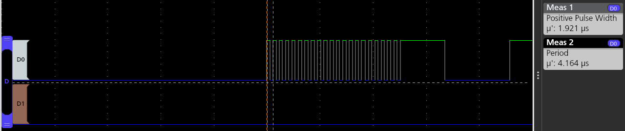

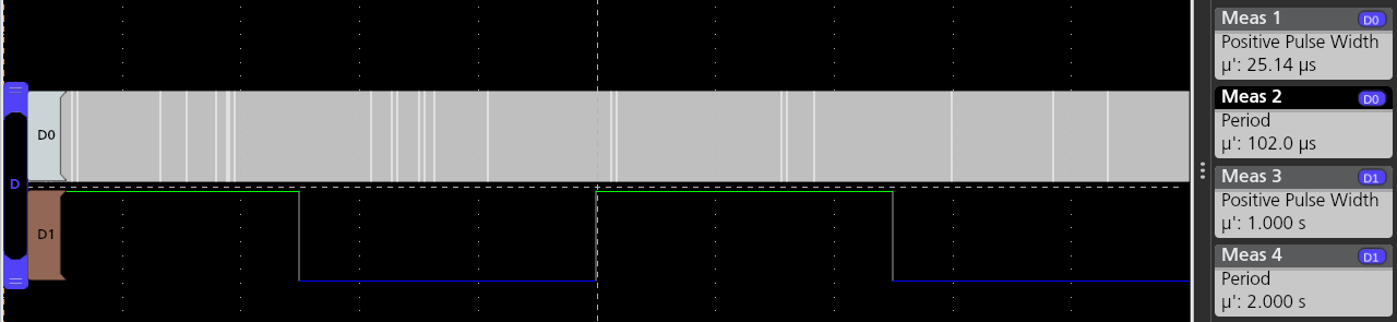

Here you can see both outputs running at once: (D0: signal, D1: LED)

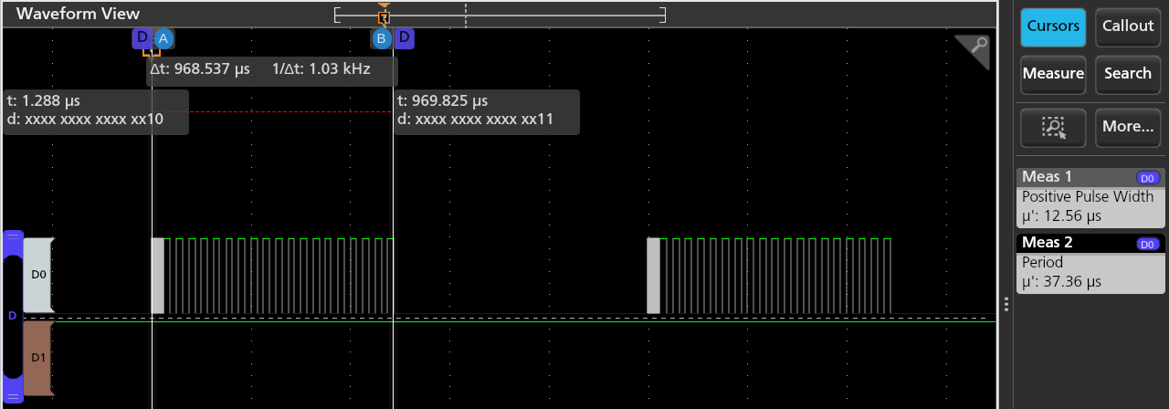

However, looking closer, you can see that the output on D0 is interrupted periodically for 1ms, every 1ms. This should just simply show a constant square wave with a period of 50us.
Furthermore, when the interruption ends, the output switches much more rapidly than expected for a while, then goes back to the expected 50us period, before being interrupted again. The rapid transitions occur with a period of about 4ms:
I have read Espressif's documentation on the tick interrupt, time-slicing, core pinning (affinity) and priotitisation. It would seem that the 1ms interrupt is connected to the tick interrupt, and the rapid transitions afterward are perhaps tasks that the scheduler delayed due to the interrupt, then executed rapidly afterwards. However, as far as I understand I have only created two tasks and pinned one task to each core. So when a new tick-interrupt arrives, neither of the tasks should be neglected in order to run some other task, and there should be no priority clashes between the two tasks.
Would really appreciate your help in understanding the cause of these interrupts, perhaps more insight on scheduling/priority/tick-interrupt, and most importantly: how I can configure my system to generate these signals constantly without interruption :)
