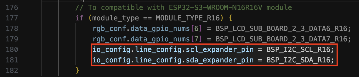

I found the problem : when upgrading from lcd V1.4 to V1.5, 4 pins have been swapped but the librairy (espressif__esp32_s3_lcd_ev_board v2.1.0) was changing only two of them.
The issue have been reported.
If I'm not wrong and we need to wait for Espressif to update the library, here's what must be changed :
In the file bsp_sub_board.c you need to add
  1.             io_config.line_config.scl_expander_pin = BSP_I2C_SCL_R16;
  2.             io_config.line_config.sda_expander_pin = BSP_I2C_SDA_R16;
Please see the picture to see where to add these lines.
Changes in bs_sub_board.c
Capture d’écran 2024-07-02 à 10.58.06.png (85.99 KiB) Viewed 4912 times
