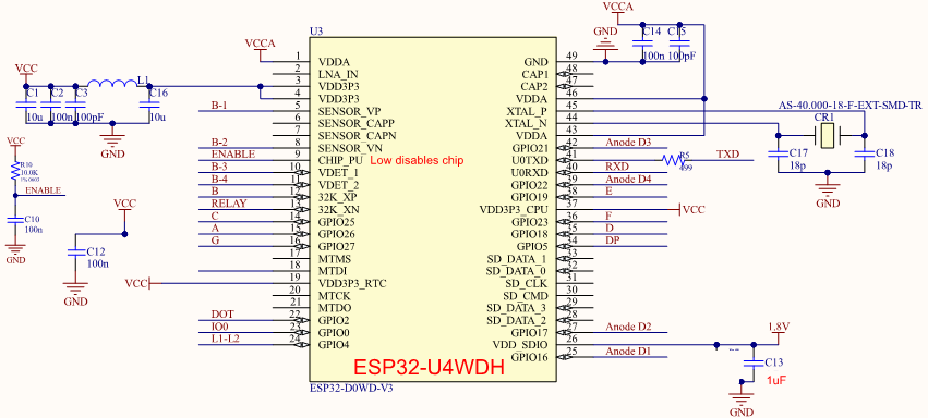

I inherited an untested target board for a new design that contains an ESP32-U4WDH. It was originally designed with a different ESP32, and not all corrections were made, but I've modified it to comply with the requirements stated on the ESP32 online "Schematic Checklist."
I'm using VS Code with ESP-IDF in Windows 11. I started with a simple program derived from a Blink example. It programs an runs successfully on an ESP32 DevKit V1. When I try to upload it to the ESP32-U4WDH on the target board via UART, I get the following output on the terminal:

I know the power supply is clean. I've put a scope and logic anaylzer on TXD and RXD and see that the signals are pretty clean. The ESP32-U4WDH sends the appropriate output stream over TXD at power up.

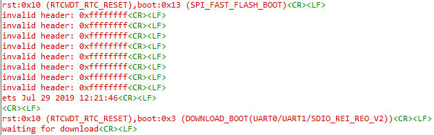

Here's what the TXD output stream looks like at powerup and just after taking IO0 low:
Where can I find the script that is running the pgm tool? I'd like to see exactly what's happening after programming that first section of memory that shows 100%. Normally I would see how many bytes were written and that the Hash has been verified. Where is the script that streams that info?

In the absence of having the flash status register info, I'll provide an update on what I've found:
1. With a logic analyzer, I've captured UART activity during the program upload process. The ESP32 DevKitM-1, which programs properly, shows CHIP_PU transitions low, then high, then the ESP32 transmits some information starting with "ets Jul 29 2019..." This message concludes with "room 4 0x0d 0x0a load:0x400804,le0xff"
2. The Target board starts out the same, but stops in the middle of the ESP32 message. CHIP_PU goes low, then high, then the ESP32 transmits some information starting with "ets Jul 29 2019...", same as above. However, here's where it's different, the message is much shorter and concludes with "FAST_FLASH_BOOT)0x0D 0x0A". This is consistent, happens every time, regardless of BAUD rate.
I don't see any changes in the CHIP_PU or GPIO0 pins when the message halts. I have noticed glitches in the CHIP_PU line on the logic analyzer, but am unable to confirm them with a scope. The glitches are either in the lines feeding signal to the analyzer, or in the analyzer software, but don't appear to be real.
I've confirmed that the DTR and RTS signals are the same on both the good and bad units. Also, GPIO0 and CHIP_PU are the same on both units up until the ESP transmit message mentioned above.

Re: Flash Write Error: Possible serial noise.
One critical problem in your board is U4WDH has differen flash assignments wrt ESP32-D0WD-V3. In U4WDH, GPIO16 and GPIO17 are used by flash, you could check this in ESP32 datasheet. Have a try to fix this point and see if you could download firmware.
Thanks ESP_LJH, that was the problem.
I saw that early on, and discounted it as the reason for blocking programming, because IO16-17 were connected only to high impedance FET gates. I still don't quite know why having them connected to FET gates would prevent programming. Maybe gate capacitance was enough to throw off timing or levels? If that were the case, I would have expected to see some differences in various BAUD rates. The failures were identical every time, regardless of BAUD rate.
Anyway, removing the FETs was in my notes from when I first got the design. It was my plan to pull them off the board as a last ditch effort even before I got your message.
Either way, I wish I had tried this right away. It would have saved a lot of troubleshooting time and effort.
Thanks again!
robin
