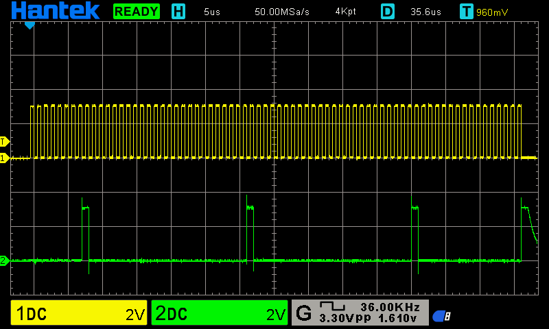

let us ensure correctness of SPI driver behavior here together: 13984.
in case of 9-bytes full-duplex I/O only 8 bytes of user rx buffer are populated. and i could believe this is correct behavior, but hardware DOES 9(since full-duplex and 2-channel scope there is no MOSI line on screen, sorry): so where is the 9-th byte, which is hardware-processed too?
i think, it's getting lost somewhere inside static inline void spi_ll_read_buffer(...) of spi_ll.h near it's for(...) loop, isn't it?
