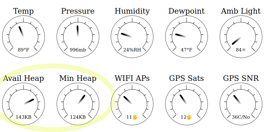

Re: WIFI sockets fail after a while
agree about memory leaks. Something like this
That code expects a monitor task to call totFreeBytes() to reload the structure, then the other functions.
I find keeping an eye on the minFreeBytes really helpful; in my typical ESP32 projects >50K is good and <20K is going to fail eventually.
Here's a web page that watches several values: That's 65 days since the last reboot.
unsigned int totFreeBytes() { // Total free bytes in the heap. Equivalent to multi_free_heap_size().
heap_caps_get_info(&sMHIT, MALLOC_CAP_INTERNAL | MALLOC_CAP_8BIT);
return sMHIT.total_free_bytes;
static unsigned int total_allocated_bytes() { // Total bytes allocated to data in the heap.
return sMHIT.total_allocated_bytes;
static unsigned int largest_free_block() { // Size of largest free block in the heap. This is the largest malloc-able size.
return sMHIT.largest_free_block;
static unsigned int minimum_free_bytes() { // Lifetime minimum free heap size. Equivalent to multi_minimum_free_heap_size().
return sMHIT.minimum_free_bytes;
unsigned int minFreeBytes(){

ESP_Sprite, Craige - thank you.
I found my malloc, that was not free'ed sometimes.
The min Heap is very usefull
And I scooped some of my structs to MALLOC_CAP_SPIRAM
So looks like, I am running stable > 90 kB free. Lets see in a couple of days

This is off topic, but I have to ask Craige about that web page with gauges.
Did you program that? Is it available on line?
I want to make a gauge display for my combine and those gauges would be ideal.
Thanks,
JP.
