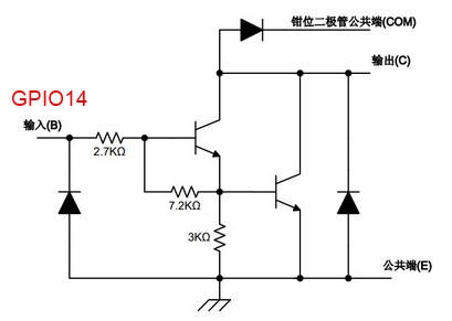

I have a weird behaviour on my custom PCB, which I do not understand.
GPIO14 is connected directly to the input of a darlington transistor.
When you check the schematic of the darlington (attachment), then you will see, that there are some pulldowns (total 13K).
:arrow: General:
Putting ESP to download mode via GPIO0 and flashing the app is always possible.
:arrow: What I cannot understand:
For some reason I do measure 880mV at GPIO14 directly after reset/EN=high - despite the darlington-internal pulldown.
How is this possible?

Hm, that does not sound like anything I've ever seen before. Are you sure there aren't any hardware issues at play, e.g. GPIO14 is also shorted to some other IO pin?

Possible, I am still checking for electr. issues/shorts.
But lets assume there is some kind of electr. short or what ever...
Why is a voltage level @ GPIO14 is influencing the boot ?
