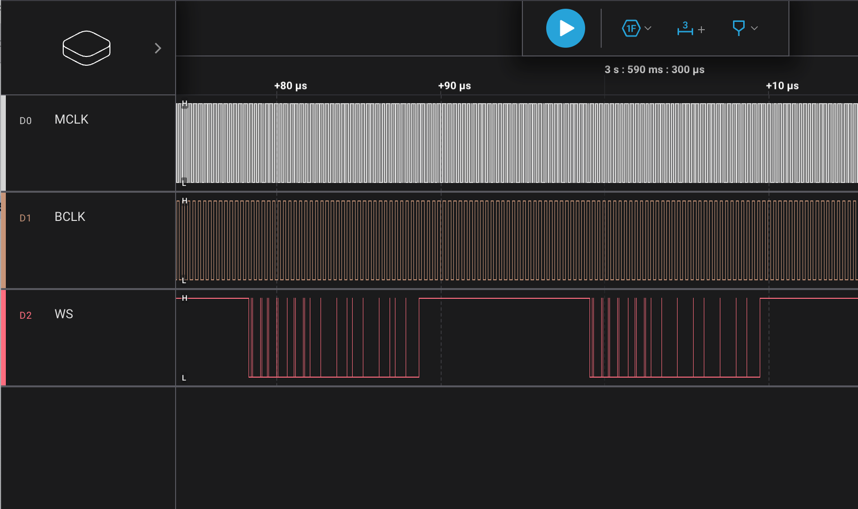

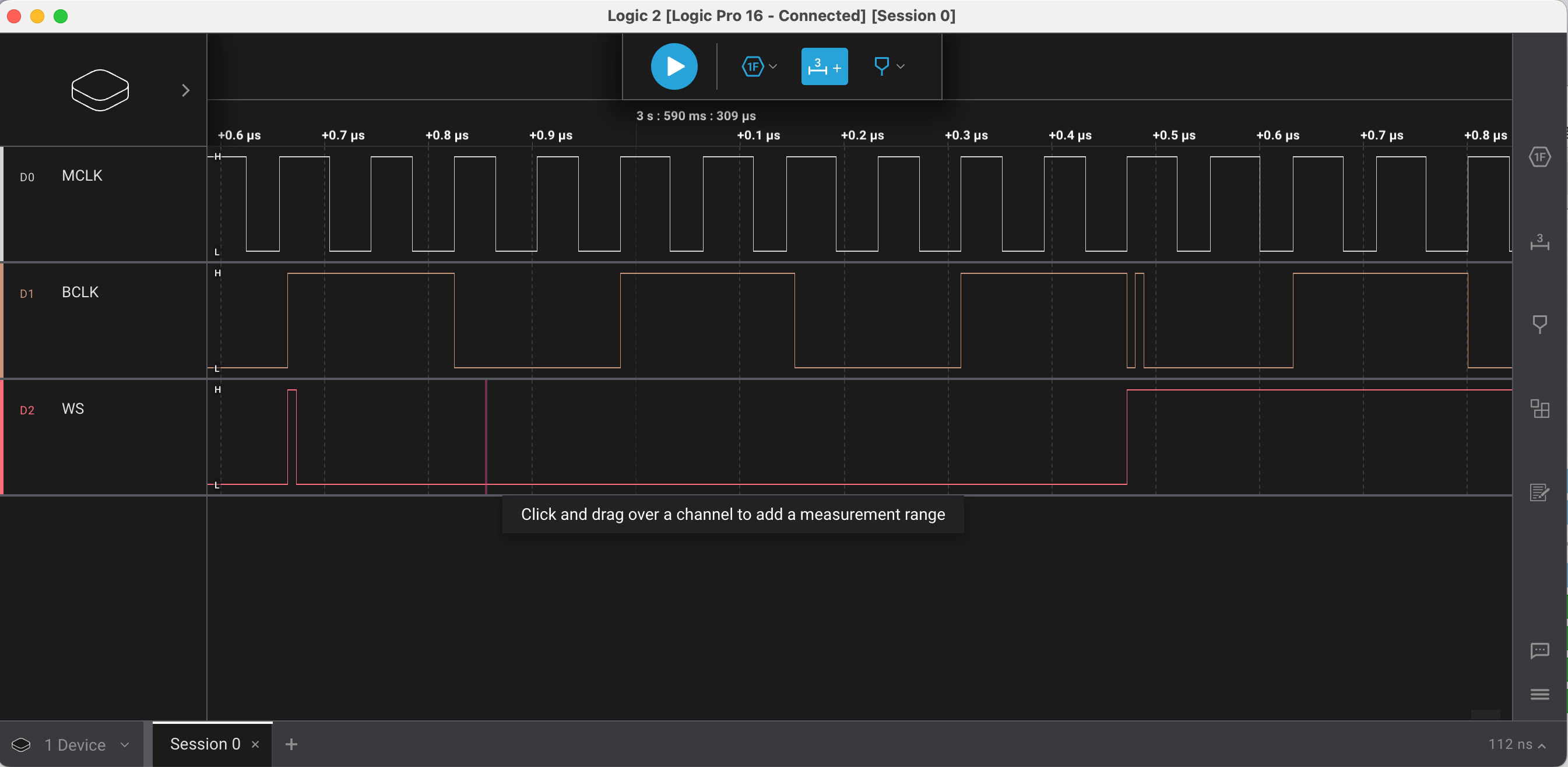

But when I look at the signal with the logic analyzer, I am seeing some bizarre things (see attachment #2). The WS signal is not good when low but is right when high.
Even the BCLK signal is not quite right. When the WS signal transition to high, the BCLK signal has a glitch (attachment #1)
Where should I look next?
Thanks.
Attachment #2
Screenshot 2024-01-10 at 12.50.23 PM.png (239.97 KiB) Viewed 23203 times
Attachment #1
Screenshot 2024-01-10 at 12.42.51 PM.png (181.37 KiB) Viewed 23203 times

That honestly looks like measurement errors. Is your LA ground connected properly and is the threshold set appropriately? Long unshielded wires running in parallel can also lead to results like this.

You are right! My mistake. I fixed my wiring and everything looks good on the logic analyzer.
Sorry about that.
