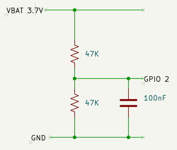

I'm using a DFRobot ESP32-C3 and want to monitor it's battery voltage using ADC1 GPIO 2. The circuit for connecting up GPIO2 is a voltage divider and a capacitor. I've verified the resistor values with a multimeter and tested for continuity.
The problem is that despite the supply into the top of the voltage divider being 3.7V, the multimeter shows 2.85V at GPIO 2. The code below returns a saturated value of 4095. I was expecting to see 1.85V at GPIO2 and an ADC reading of around 3000.

Schematic for your board reveals a 10k pullup on GPIO2:
https://dfimg.dfrobot.com/nobody/wiki/3 ... 106295.pdf

Awesome! Thank you so much @boarduz for pointing this out, I was pulling my hair out last night. Lesson for me is to exercise more caution over using the strapping pins (2,8,9) and to go back to the schematic. This is only the second board I've used so lots to learn.

I've switched to using GPIO3 and confirm all working! Thanks again.
