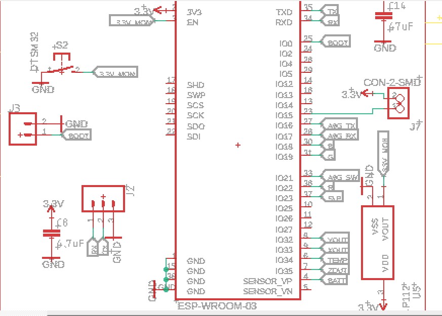

Hi all,
I have a custom PCB with an ESP32 as the microcontroller, and peripherals connected to it. According to the datasheet, in deep sleep mode, the current drawn is supposed to be less than 0.15 mA. However, my board is drawing 7 mA in deep sleep. I've attached the circuit diagram to the post.
What could the issue be?
Here's the code that I flashed into the esp32:

Postby liaifat85 » Sun Dec 17, 2023 7:55 am
Since it's a customized PCB, I think you should perform a QC of your PCB. Test with a multimeter. Find out if there is any accidental short circuit somewhere.

Re: ESP32 drawing too much current
Postby MicroController » Sun Dec 17, 2023 2:53 pm
What's U5?
