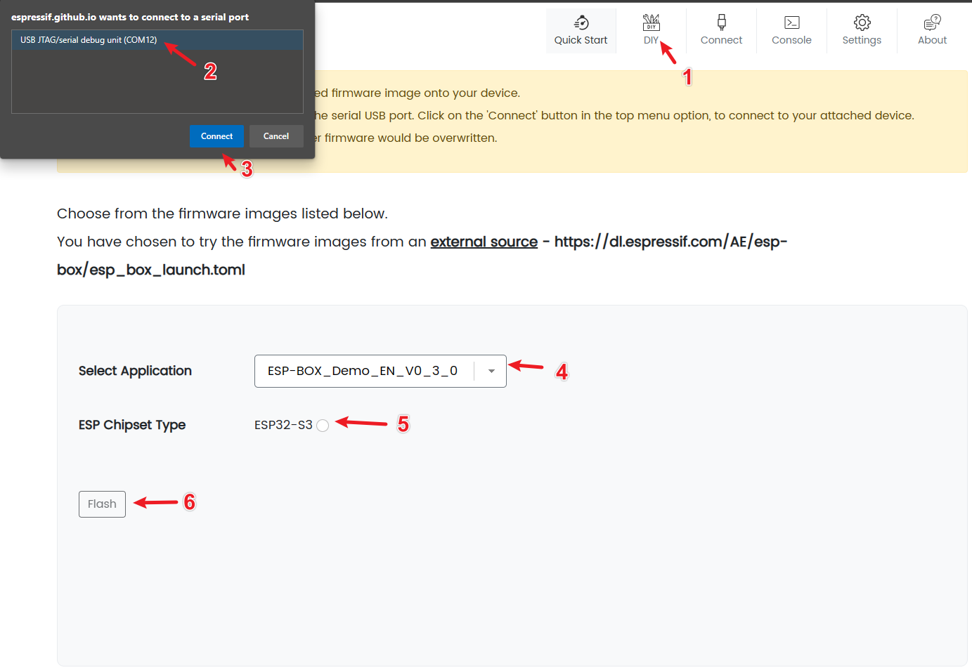

- For my ESP Box 3 I tried to reconstruct the factory demo. LaunchPad is not working and the firmware for Box-3 (...bin) ist still not available. Please provide it for easy use and reset to delivry status.
- I am working with Win 10 and standard ESP-IDF 5.1.1. Using that IDF seems to be more reliable that VSCode-IDF.
- I did not dare to flash_read all flash in order to save its initial state because I read, that flshing back the boot area is only for people how know what they are doing - not for me!
- The advice is to rebuild the demo from source "esp-box-master". OK, should be no problem. I set-target esp32s3, struggled with menuconfig, but for me everything looked fine. Then idf.py build ... ERROR.. I am not shure, if any log or any longer dump will help, this is what happened:

The ESP LaunchPad for ESP-BOX project is not supported on Safari & Firefox browsers yet! Please try using another browser like Google Chrome.
Please follow the instruction to upload build-in factory firmware of ESP32-S3-BOX-3. The latest version is ‘ESP-BOX-3_Demo_V1_2_3’.
ESP-LaunchPad: https://espressif.github.io/esp-launchp ... aunch.toml
