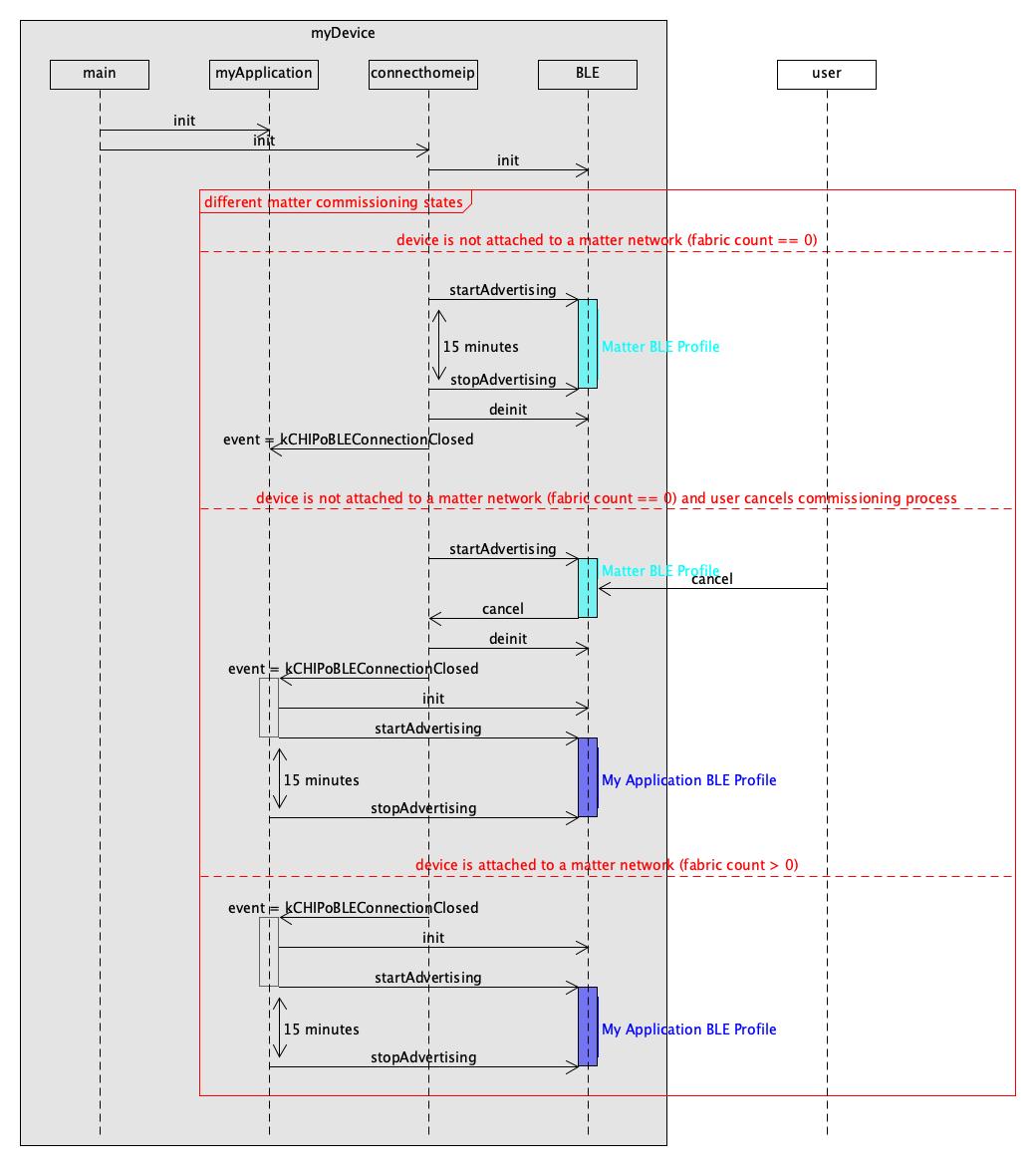

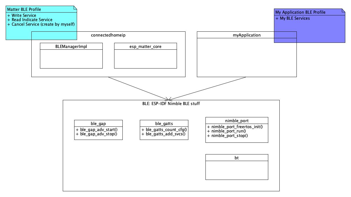

Some more information for better understanding of my problem. My goal is to change as little as possible in the existing esp-matter implementation. To achieve this, I wanted to start Nimble BLE with my BLE profile as soon as the esp-matter SDK tells me that BLE is no longer needed for Matter/CHIP.
As an extension, the Matter BLE profile should be supplemented with an abort service so that the user (my smartphone app) can change the BLE profile.
To illustrate this, I have drawn a simple sequence diagram. The very abstract component diagram should roughly show the dependencies and the associated BLE profile and make it clear that I only want to create/change the component "myApplication".
