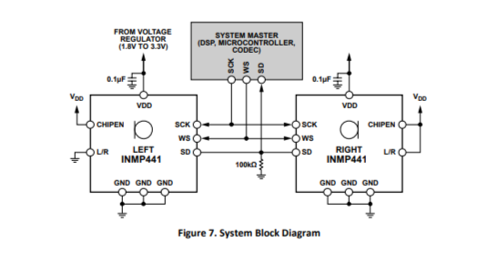

Postby andreyVylix » Sun Nov 12, 2023 8:03 pm
I connected two microphones according to the following scheme. Both microphones work in mono format. When I try to get a signal in stereo format (RIGHT_LFET), the useful signal is only on the left channel ( x = 0, 2, 4 .... 418), and random values are received from the right channel (x = 1,3...419). It is also unclear to me why half (x = 420...819) the read values are 0, in any I2S format. Because of this, in stereo mode, there is only 820/4 per channel.
The main problem is how to make INMP441 work in stereo format ?
