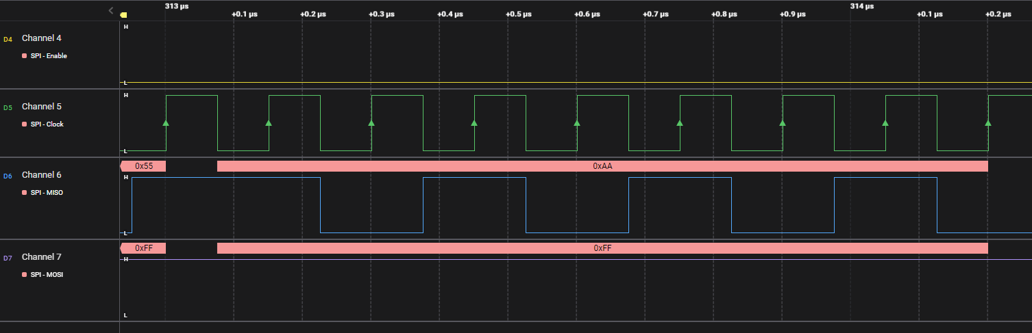

This is comparable with our measurement:
The change on the MISO line is here slightly after a falling edge. So the ESP reads here 0x55 and also our logic analyzer reads 0x55.

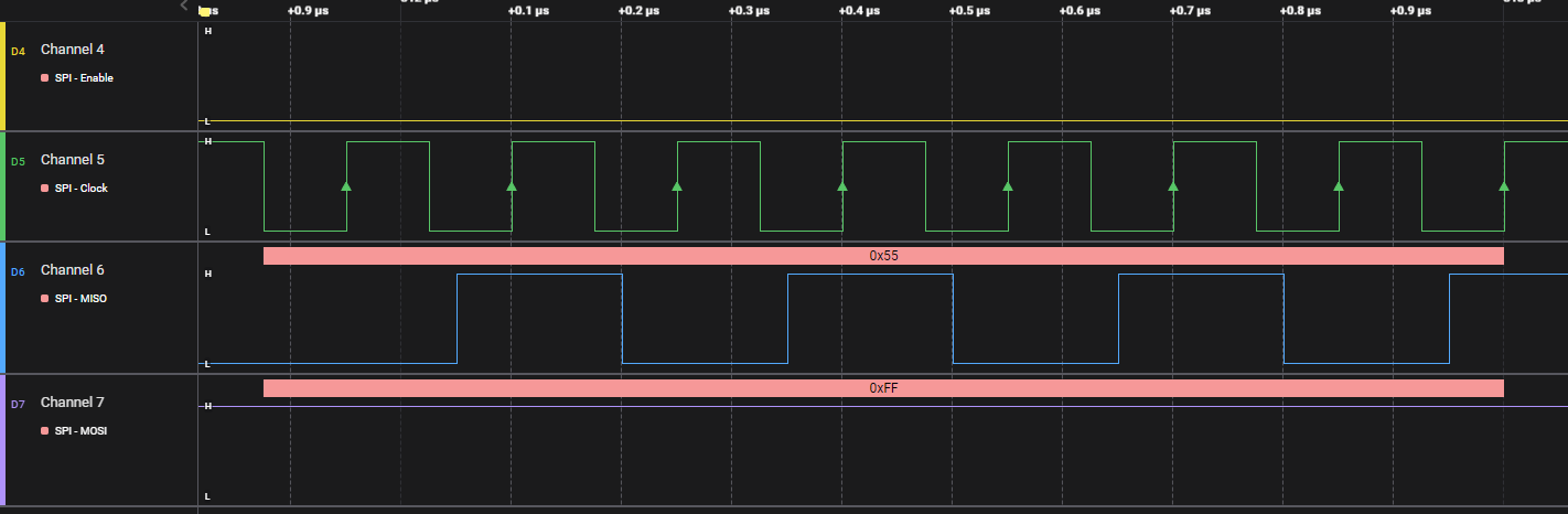

The MISO line is here changing exactly on the falling edge … from time to time, the MISO is also changing its line shortly before the falling edge. In this case the ESP cannot read the data and reads out 0x54, the logic analyzer still reads the correct data of 0xAA.
In my mind the ESP should not care about the transition of the MISO line, it should only check the actual state of the MISO line at the rising edge of the clock. Is there any idea how we can solve that problem?

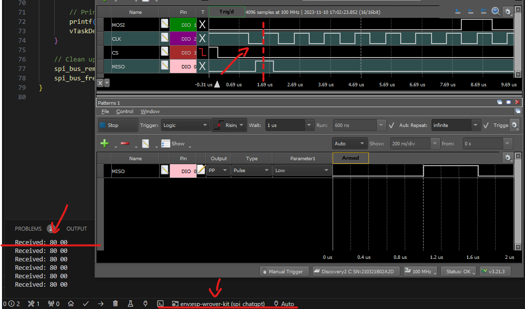

I had a look into the Esp32-S3 Reference Manual and according to that MISO Line should be sampled on the rising edge of SCLK:
I wrote a quick program to check this:

On the ESP32 it showed me a correct result (0x80) when i inject a pulse on the MISO line during rising edge of SCLK:

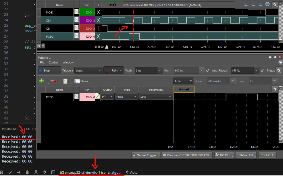

However on the ESP32-S3, running the exact same code (SPI-Mode 3) I get a 0x00!
chris6347
Joined: Fri Nov 10, 2023 7:46 am
Re: SPI Master fails to read MISO correctly on Mode 3
Postby chris6347 » Mon Nov 13, 2023 12:27 pm
One more info:
I have tried moving the high pulse over the falling edge, and suddenly the ESP32-S3 recognizes it, even though in it's SPI-Mode 3:
ESP IDF version is 5.1.1.
This seems to be like a major bug in either ESP IDF, or worse, the ESP32-S3 silicon, or not?
