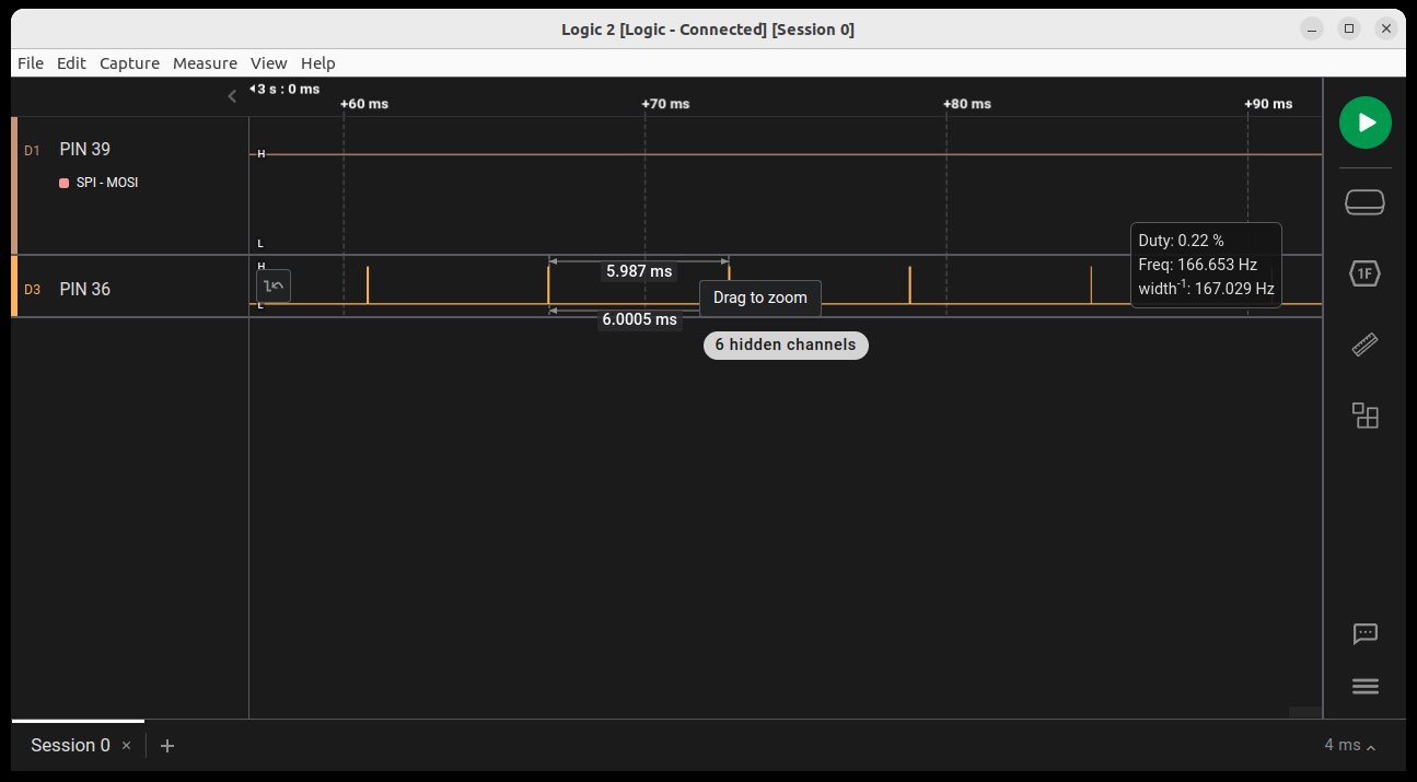

I have "timing related" issues while using together several IO as outputs and bt_controler.
I've built a minimal code and you'll get some explanations below:

ESP-IDF 4.4.5 on ESP32-S3

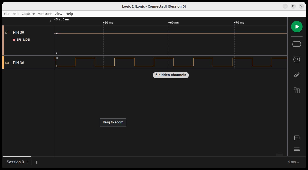

This basic code is intended to toggle gpio 36 every 3 milliseconds and it does what it should in the above configuration.
Now, if I uncomment one of the two commented lines (eg. esp_bt_controller_init() or gpio_config(&io_conf)), it works the same.
But if I uncomment both the two commented lines (eg. esp_bt_controller_init() and gpio_config(&io_conf)), here's the result:
The period is correct but not the frequency...

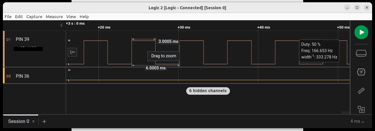

Note : If I use gpio 39 instead of gpio 36, it works on all situations:
I've looked in the documentation, and in sdk config file and did not find any specific behaviour for gpio 36 pin and the relationship between those 3 functions calls is definitively not obvious to me...
Any idea would be greatly appreciated.
Thanks
Julien

What board/module/SoC are you using?
When using Octal Flash or Octal PSRAM or both, GPIO33~37 are connected to SPIIO4 ~ SPIIO7 and SPIDQS. Therefore on ESP32-S3R8 / ESP32-S3R8V board GPIO33~37 are also not recommended for other uses.
