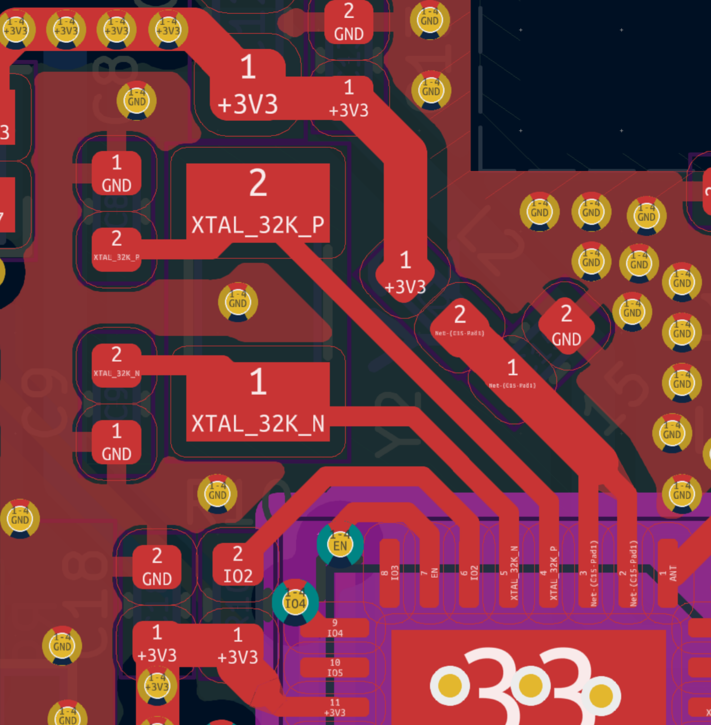

I'm having trouble with the 32.786kHz crystal; it doesn't start!
One board is Wemos C3 Pico https://www.wemos.cc/en/latest/c3/c3_pico.html; I tried two different crystals, different capacitors, tried to put a resistor in parallel (though the hardware design guidelines document says it must not be needed) - nothing helped.
Another board is a custom board with a crystal from a yet different manufacturer - still no luck.
I checked Espressif's reference designs for the boards using ESP32-C3 but none have the external crystal; is there any reference design with the working 32K crystal? Any recommendations what to check?

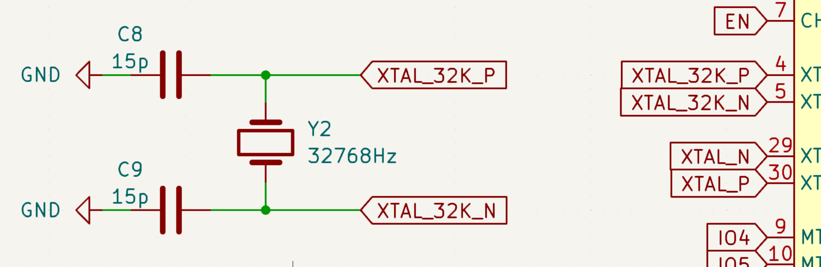

The capacitors are 15pF each and the crystal is JGHC S3132768092070.

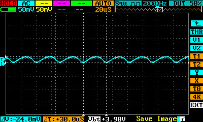

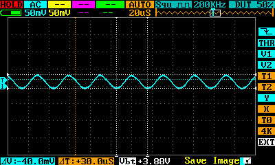

I tried to check with an oscilloscope and I see 32768 Hz oscillations, around 0.4V in amplitude. Is that not enough? The firmware doesn't detect any ticks. What am I missing?
crystal
schematic
pcb
HamGuy

cyber_v1
Posts: 10
Joined: Thu Oct 05, 2023 12:28 pm
Re: ESP32-C3 design with external 32.786kHz crystal
Postby cyber_v1 » Fri Oct 06, 2023 3:15 pm
Here you are, using a 10x probe.
AFAIU pin 4 is the "input" of the crystal and pin 5 is the output. So the output is around 0.24V :?
pin 5
pin 4
I'd take that as a sign that the oscillator in the ESP is successfully running the crystal.

Btw, the amplitude of the oscillation is not really meaningful. It's basically determined by the hysteresis of the oscillator's input, for which 0.3V seems reasonable. If the amplitude wasn't high enough to 'toggle' the oscillator it wouldn't be oscillating.
