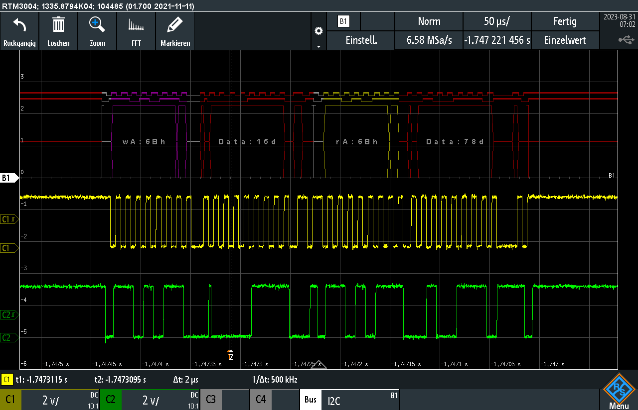

I'm currently facing some problems when reading registers from an IC via I2C.
I'm getting like hundres of correct reads, but at some point I get an incorrect one.
I've watched the I2C lines with an oscilloscope and the data looks fine, so the problem happens internally.
This is 78 (0x4E) as expected, but in the code I get 163 (0xA3). The picture shows exactly that register read, that returns an invalid value.

I think it is an internal timing issue. It is only happening when A2DP sink (https://github.com/espressif/esp-adf/bl ... _example.c) is active and music is playing (via bluetooth). Only when playing music. If bluetooth and A2DP are enabled without playing music from the connected device, everything is fine.
I'm reading the register every 100ms and after like 5-20min I'm getting one incorrect reading.
I'n every case I've watched, the wrong reading was 163 (0xA3). The datasheet of the IC says, that the 7bit (MSB) always reads 0.
Normally I expect values like 80(0x50) or 78(0x4E). Something below 128 (0x80).
There are 10k pullup resistors on SDA and SCL. Internal pullups disabled.

No, as the I2C master, the ESP provides SCL. If, for whatever reason, there would be some delay on the ESP side, it would, worst-case, briefly stop SCL but not corrupt any data.
0xA3 happens to be (0x51<<1)+1, which may be a hint that the first bit (MSB) gets missed. In theory, this could happen through a glitch (iterference) on the SCL line, but why would that happen on exactly the same bit each time?
Another possibility is that there's a problem/glitch during the preceding write so that the read returns data from the wrong register.
And, of course, there's always the possibility that some code corrupts a byte in RAM used while transferring data from the I2C controller to application code.

MicroController wrote: 0xA3 happens to be (0x51<<1)+1, which may be a hint that the first bit (MSB) gets missed. In theory, this could happen through a glitch (iterference) on the SCL line, but why would that happen on exactly the same bit each time?
I'm with you on that one, but in the mean time I saw different cases with different register values and there is no easy correlation I can see (no shifting or bits missing/changed). The "invalid" reading isn't always 0xA3, it depends on the register value. But for every register value the "invalid" reading is the same all the time.
MicroController wrote: Another possibility is that there's a problem/glitch during the preceding write so that the read returns data from the wrong register.
The picture from the oscilloscope above is actually exactly the one reading that gets misinterpreted. So the external IC isn't sending a value from another register. And the signal itself is also fine. But maybe I misunderstood what you mean.
MicroController wrote: And, of course, there's always the possibility that some code corrupts a byte in RAM used while transferring data from the I2C controller to application code.
Yes, that's still a possibility, but very hard to find. I'll investigate.
ESP_Sprite wrote: Agree with this, 10K is generally too high for I2C communication. Note that internal pullups won't really do much here; they're generally around 50K so they won't make much difference.
Thanks for your input! I changed them to 4k7.
UPDATE: I'm getting rid of the problem by changing the master clock from 100kHz to 10kHz.
