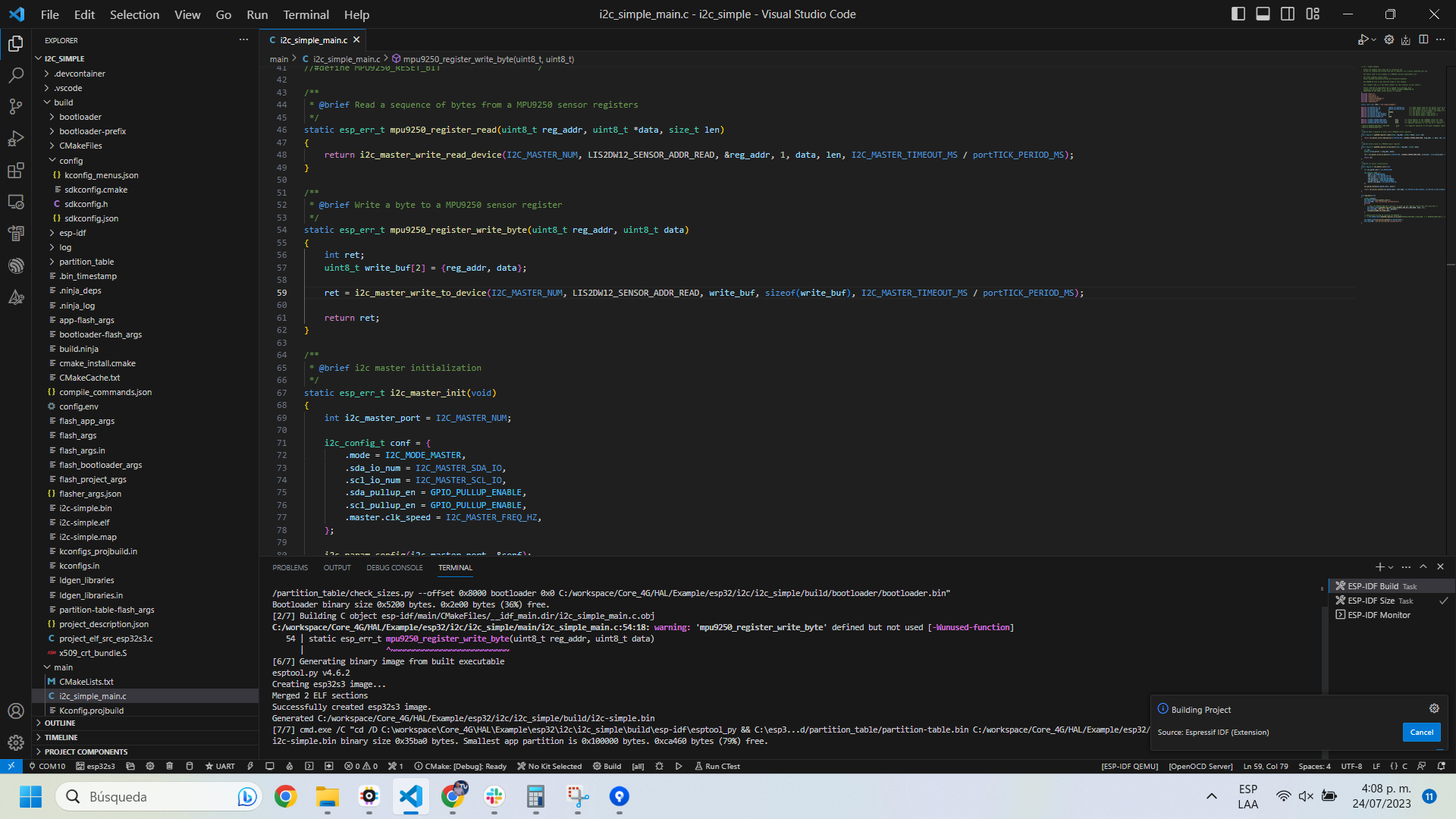

Postby jprpower104 » Mon Sep 25, 2023 9:49 pm
inside of "async_memcpy_isr_on_rx_done_event(mcp_impl);" i have this captureImage and next line of code in portENTER_CRITICAL_ISR(&asmcp->spinlock); asmcp have all data, but in the static inline void __attribute__((always_inline)) vPortEnterCritical(portMUX_TYPE *mux)
xPortEnterCriticalTimeout(mux, portMUX_NO_TIMEOUT);
mux is totally null values
Captura de pantalla 2023-07-24 160849.png (317.9 KiB) Viewed 32687 times
