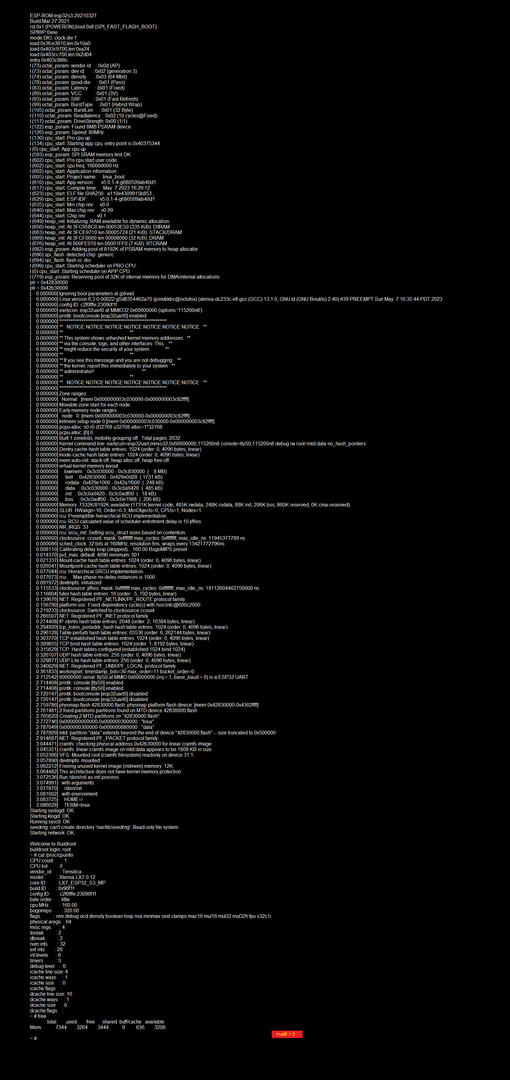

i heard you, - here you are 240 MHz,
[ 0.000000] rcu: Preemptible hierarchical RCU implementation.
[ 0.000000] rcu: RCU calculated value of scheduler-enlistment delay is 10 jiffies.
[ 0.000000] NR_IRQS: 33
[ 0.000000] rcu: srcu_init: Setting srcu_struct sizes based on contention.
[ 0.000000] clocksource: ccount: mask: 0xffffffff max_cycles: 0xffffffff, max_idle_ns: 7963585194 ns
[ 0.000081] sched_clock: 32 bits at 240MHz, resolution 4ns, wraps every 8947848189ns
[ 0.008099] Calibrating delay loop (skipped)... 240.00 BogoMIPS preset
[ 0.014307] pid_max: default: 4096 minimum: 301
[ 0.019108] Mount-cache hash table entries: 1024 (order: 0, 4096 bytes, linear)
[ 0.026465] Mountpoint-cache hash table entries: 1024 (order: 0, 4096 bytes, linear)
[ 0.070816] rcu: Hierarchical SRCU implementation.
[ 0.071445] rcu: Max phase no-delay instances is 1000.
[ 0.083606] devtmpfs: initialized
the first hello world on the target you know?
it's a cross compiled rootfs,
done!
buildroot login: root
Password:
Jan 1 00:09:18 login[56]: root login on 'console'
~ # helloworld
Hello World
CPU count : 1
CPU list : 0
vendor_id : Tensilica
model : Xtensa LX7.0.12
core ID : LX7_ESP32_S3_MP
build ID : 0x90f1f
config ID : c2f0fffe:23090f1f
byte order : little
cpu MHz : 240.00
bogomips : 480.00
flags : nmi debug ocd density boolean loop nsa minmax sext clamps mac16 mul16 mul32 mul32h fpu s32c1i
physical aregs : 64
misc regs : 4
ibreak : 2
dbreak : 2
num ints : 32
ext ints : 26
int levels : 6
timers : 3
debug level : 6
icache line size: 4
icache ways : 1
icache size : 0
icache flags :
dcache line size: 16
dcache ways : 1
dcache size : 0
dcache flags :
Segmentation fault
also if too fast, 80MHz - we can switch. WoWZa
..we have a switching #PSRAMBANK btw..
also the second CPU is on the way
rudi
ps
you have an ESP32-S3-N8R8 ?
You want try? All things are online if you need.

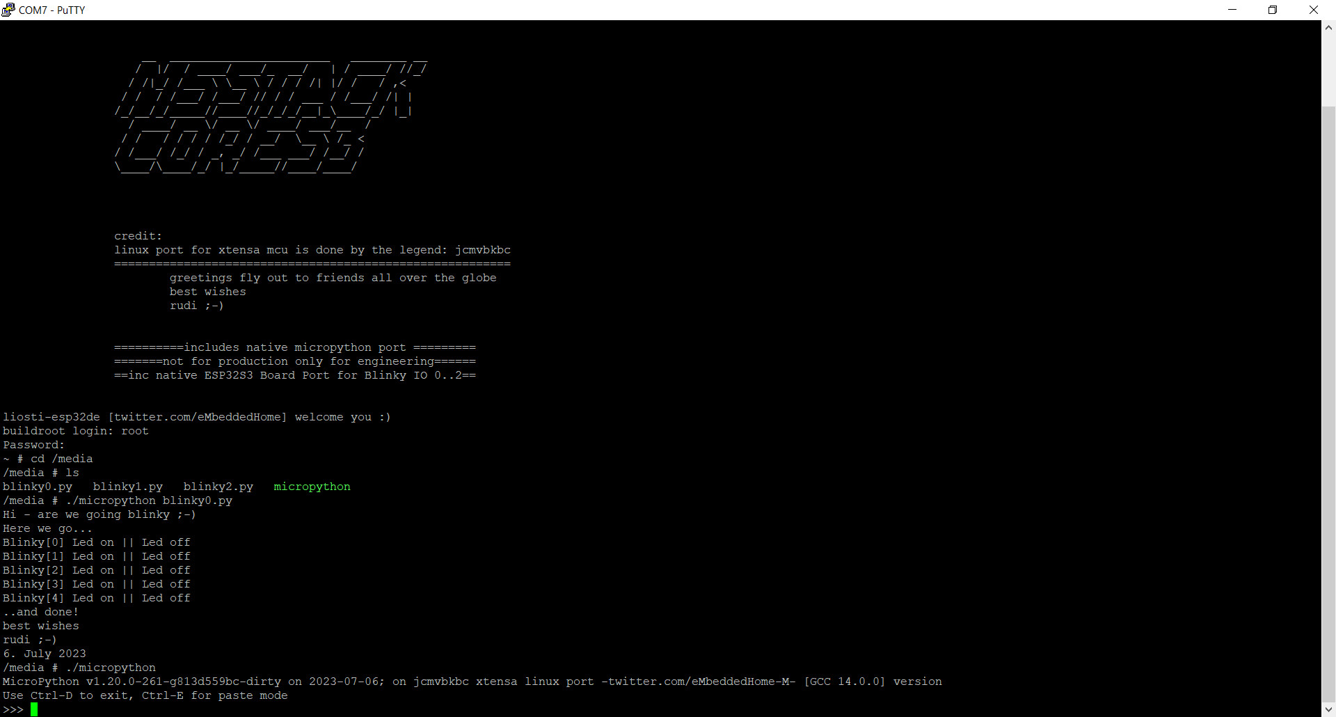

update:
29 May 2023
blinky , it's working fine.
Just in time happens: SDMC / USB Host ( mounting flash drive )
Next driver step: I2C / SPI
rudi

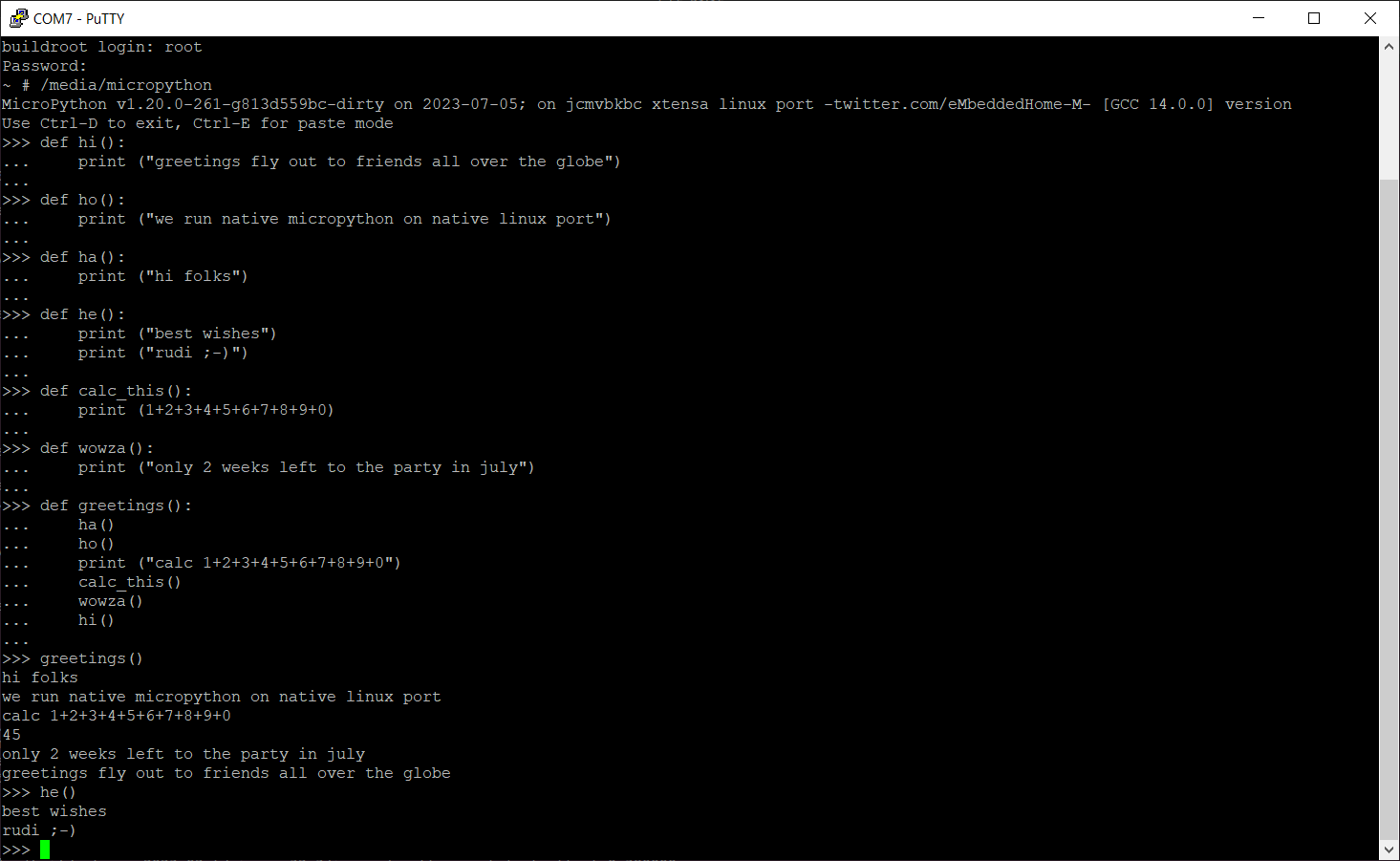

micropython port on S3Linux port
update:
- native micropython -just for show up- port
- linux port add to the boot partitions bootloader
hi folks
you can use micropython on this linux port
test firmware uploaded
example test:
ESP32-S3 with 16MB quad flash and 8 MB quad psram
example on m5stackCoreS3
- fw for your own test
ESP32-S3 with 8MB quad flash and 8 MB octal psram
example on
- ESP32-S3-DevKit N8R8
- olimex ESP32-S3-DevKit-Lipo OSHW board
the hello world ( blinky )
also the linux port was add to the boot partition bootloader
rudi

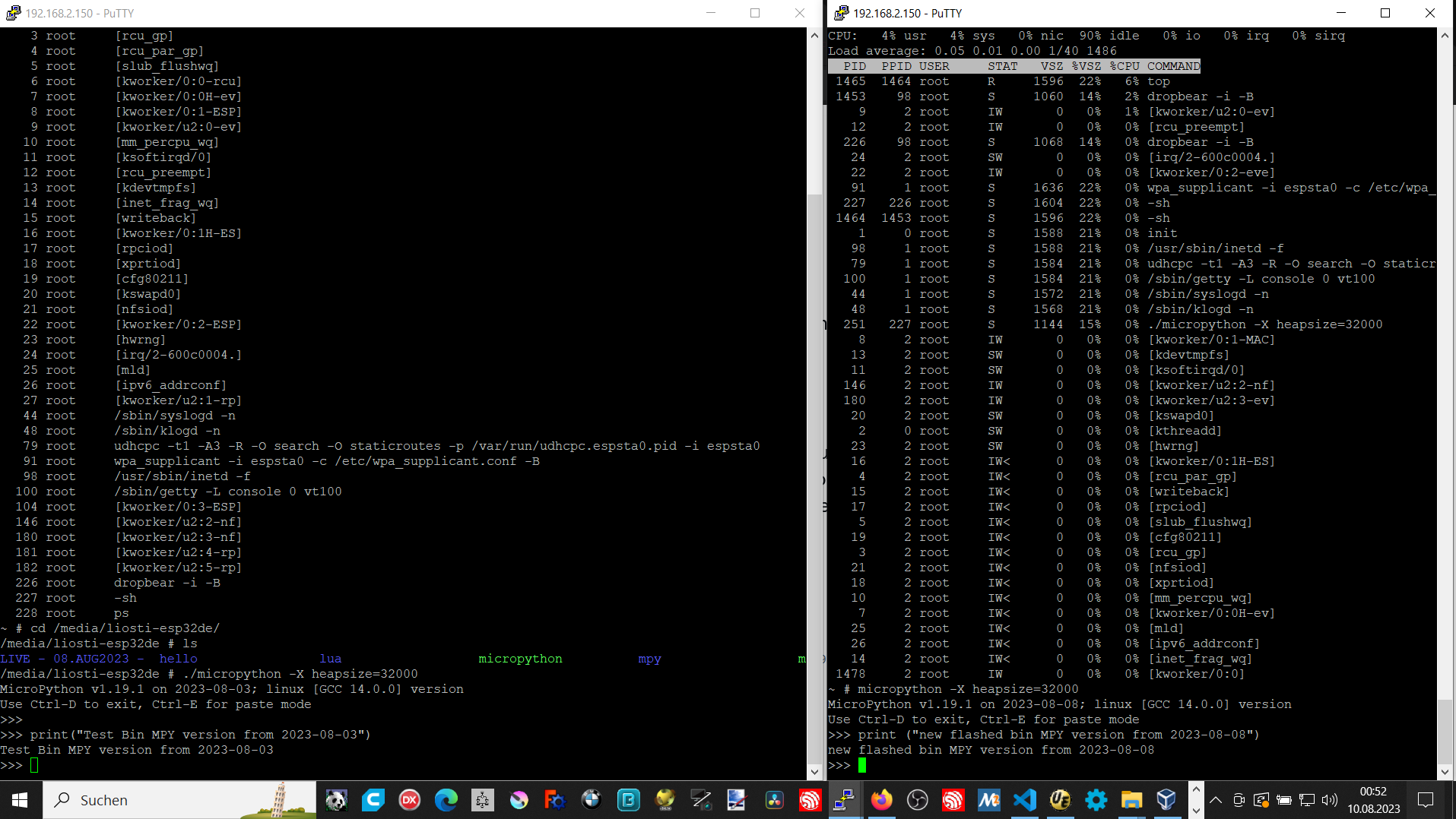

Remote Build by ESP32-S3 SSH Client which runs #jcmvbkbc #esp32s3 #linux #esp32 S3 port
10. Aug 2023
the YT Video shows all steps:
( JFYI: i did the same technic ( remote compile on an NFS/SSH Server ) june/2016 for the ESP8266
whats not new is - but new is, the Linux SSH client on the ESP32-S3 MCU can trigger this by self on demand
showing simple things by second SSH client which can be " a script" i hope you get the idea behind -
there is also now a 100GB NFS Share mountet which we use as executable space for the ESP32-S3 - and that is amazing!
we can run example 2 different mpy versions same time, the one from S3Linux userspace, and the second from the
"100GB Developer/cloud live compilation" - we see live the change of each compilation, not need any more,
rebuild rootfs ( userspace ) 100x and reflash ESP32-S3 - we do simple the Develop in the mounted CLOUD SPACE.
( LUA YT Video ) also Micropyton installed
NFS Client runs on S3Linux and mounts a NFS Share (100GB) over WiFi
local console runs on wifi ssh server, 2 ssh clients connected per wifi and runs micropython port.
is this the world's first micropython server on a MCU?
rudi
