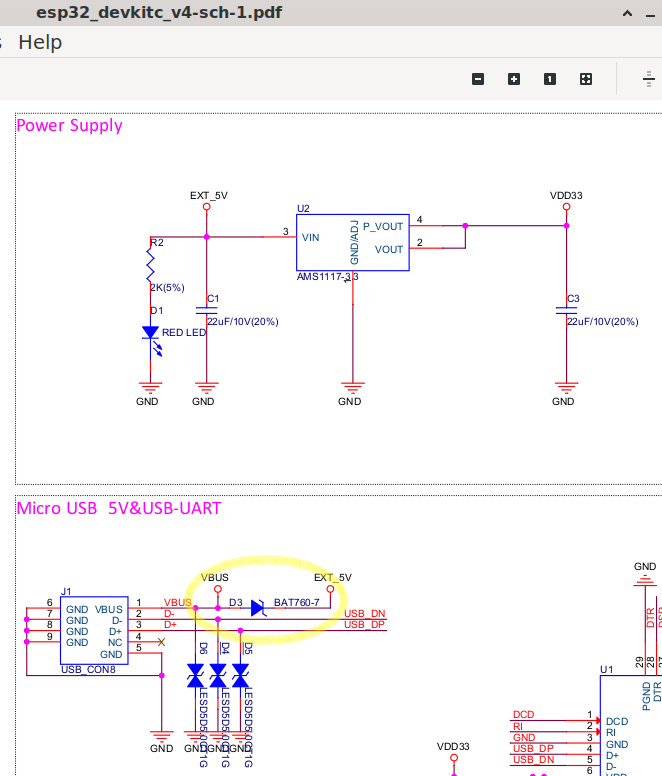

I'm not connected the USB header to anything other than my laptop, and I do power the chip from an external 5V source directly on its USB pin, and it should be about 5V. Is there a way to fry the USB chip without frying the ESP32 voltage regulator?

You have connected two 5V power supplies to the board (power supply + laptop USB) at the same time?

I don't know about wemos/lolin, but the dev kit c shows a blocking diode between the laptop/usb supply and the EXT_5V pin. The usb 5V supply is frequently not enough amps to support wifi without an external 5V supply, so I've been using both supplies with the random devices I get from amazon. I'd be concerned if
is avoiding the blocking diode...concerned for the laptop if 5V is pushed into the usb.and I do power the chip from an external 5V source directly on its USB pin

Yes, I have. 5V from battery and voltage regulator, and sometimes I connect the USB to my laptop which indeed supplies 5V also. And yes, the 2 5V are not exactly the same so it could cause a small current flow from 5V rail to USB 5V pin.MicroController wrote: ↑Sat Apr 01, 2023 9:49 pmYou have connected two 5V power supplies to the board (power supply + laptop USB) at the same time?
Would that be enough to damage the USB chip on the board?
Generally is there a safe/accepted way to power via 5V and reflash via USB outside of unplugging the chip and/or turning off the external 5V source?

So let's be precise, this is what the lolin D32 looks like:Craige Hales wrote: ↑Sun Apr 02, 2023 12:19 pmI don't know about wemos/lolin, but the dev kit c shows a blocking diode between the laptop/usb supply and the EXT_5V pin. The usb 5V supply is frequently not enough amps to support wifi without an external 5V supply, so I've been using both supplies with the random devices I get from amazon. I'd be concerned ifis avoiding the blocking diode...concerned for the laptop if 5V is pushed into the usb.and I do power the chip from an external 5V source directly on its USB pin
https://www.wemos.cc/en/latest/_static/ ... _16x16.jpg
The only pin that has 5V is the pin labelled USB.
This pin is labelled VBUS on the schematic and seems to be the same USB VBUS than pin VBUS on the board
There is a VIN label on the schematic, but I don't see where it goes, although it's behind a diode indeed
Schematic: https://www.wemos.cc/en/latest/_static/ ... v1.0.0.pdf
Either way, from what I can read, connecting both my battery on VBUS and the VBUS USB pin to my laptop does seem to connect to different power supplies together with 0 protection between them. My laptop is protected and the Vreg on my battery is also protected, so a tiny backflow would not bother it, but the resistance between them is almost 0, so this could create a hgh current that could burn a trace on the board maybe? (never saw or smelled magic smoke though).
Either way, it looks like dual powering this board during flashing, is a bad idea. Is that correct?
If so, I have a magic USB cable where the V+ line is cut, and I could use this to connect my laptop while it's battery powered.
As per the earlier comment, yes the entire system uses too much power from USB, so I cannot connect USB only if I want it to work, but I could unplug the chip to flash it, and then put it back. Using a USB cable with V+ cut off is likely simpler though.
