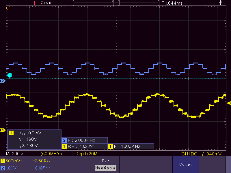

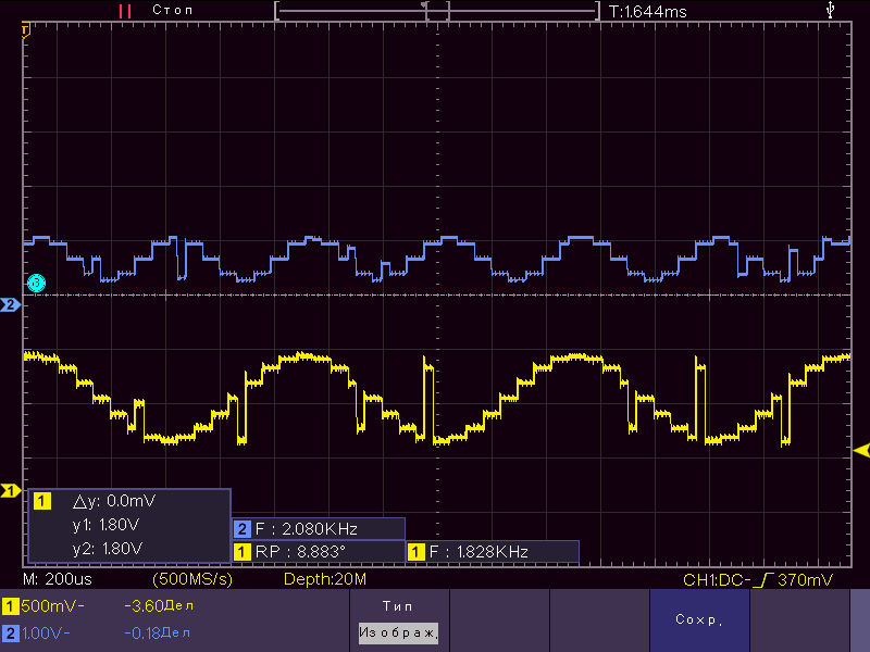

I try to generate sine via I2S and internal DAC but i have some isues with it.
If i use APLL clock for I2S it make me possible to gen my signals but i got glitches.Hi.
pll_2d_clc is useles, i cannot configure I2S rate to get my sine freq.
My sine is 1kHz and 2kHz and sample rate 16kHz
First i tryed IDF v4, now v5.0.1.
Board is ESP32-wroom-32d
Is it hardware issue?

corz.org
Posts: 80
Joined: Fri Feb 03, 2023 10:44 pm
Location: Aberdeen
Contact:
Re: I2S to internal DAC with APLL make noises.
Postby corz.org » Fri Mar 24, 2023 11:46 am
Try using the DACs built-in cosine generator.
