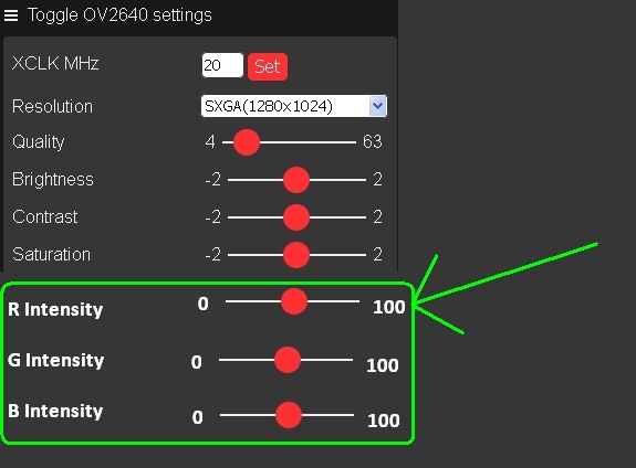

I trying to add some functionality to CameraWebServer project.
I add some variables and logic code to do this. For example:
else if (!strcmp(variable, "contrast"))
res = s->set_contrast(s, val);
else if (!strcmp(variable, "brightness"))
res = s->set_brightness(s, val);
else if (!strcmp(variable, "LED_R")) //<- my code
LED_R = val;
else if (!strcmp(variable, "LED_G"))
LED_G = val;
else if (!strcmp(variable, "LED_B"))
LED_B = val;
else if (!strcmp(variable, "saturation"))
res = s->set_saturation(s, val);
p += sprintf(p, "\"brightness\":%d,", s->status.brightness);
p += sprintf(p, "\"contrast\":%d,", s->status.contrast);
p += sprintf(p, "\"LED_R\":%d,", LED_R); //<- my code
p += sprintf(p, "\"LED_G\":%d,", LED_G);
p += sprintf(p, "\"LED_B\":%d,", LED_B);
p += sprintf(p, "\"saturation\":%d,", s->status.saturation);
Also additional ledcSetup and ledcAttachPin function calls, to configure PWM RGB outputs;
It (LED PWMs)works fine parallelly to video streaming.
But I also have to add additional sliders into webpage code, to allow remote control of the RGB values:
I have skills in writing/modifying HTML/PHP code, but I don't see webpage source code nowhere in CameraWebServer files. No in CameraWebServer.ino, no in app_httpd.cpp, no in another files.
Could You give me any idea where can I find this source code, to modify it?
Thank You in advance.

There seems to be two versions of this sketch on my systems. One has nice HTML files you can edit named index_other.h, index_ov2640.h, index_ov3660.h, etc.. and the other has a camera_index.h which is a nasty HEX integer array declaration of gzipped data you most likely need a 3rd-party tool to decode.
https://github.com/easytarget/esp32-cam-webserver
Might be a better starting point.
[edit: fixed link]

Decode of this was quite simple.
It was enough to convert from the .f format to the RAW file (save with .gz extension).
And decompress it in 7ip.

The html code is compressed and zipped and is stored in camera_index.h file in the project.
Based on the sensor you are using that file gets sent to you browser to be rendered. I believe
the header tells the browser it is a zip file. Anyways, the browser knows how to handle it.
The link below shows how to get the html code in a format you can understand, edit and put back into a
compressed zip format if you like.
https://robotzero.one/esp32-cam-custom-html/

I already did this part successfully (decoding h array, and gz decompression) using my own methods.
But I have another two unexpected troubles.
There is that part of code:
#define index_ov2640_html_gz_len 6787
I thought that is the size of gz file, so I would be able to edit html code, compress it back to gz, and update this number.
But not. Original gz file have completely different size that index_ov2640_html_gz_len value.
It have 24798 B.
So what is the number 6787 for?
Another strange thing for me: gz file decompress into one html file, with 3 versions of webpage in it (for ov2640, ov3660 and ov5640).
It have for example 3 title and 3 body tags, which goes beyond my current html programming knowledge.

The number is the size of the html file in bytes. I get the number by opening the compressed, zipped file in my text editor which counts characters so I get my size by dividing by 5 for example ,0x34 so to the editor that is 5 characters.

Of course this is the best way, which I wanted to use at the beginning, but I was unable to find proper source code on github.
So thank You very much!
Thanks to noweare too.
I edited html file as I wanted.
