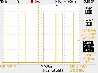

try
oscilloscope displays sequences of three pulses
- // ESP32 timer interrupts - three pulses 100Usec 350uSec 750uSec
- #define pin 19
- hw_timer_t *timer = NULL;
- // timer ISR invert pin level
- volatile int counter = 0;
- void ARDUINO_ISR_ATTR onTimer() {
- static int timer1=350;
- counter++;
- // digitalWrite(pin, !digitalRead(pin));
- gpio_set_level((gpio_num_t)pin, HIGH); // HIGH pulse
- // set next interrupt time
- timerAlarm(timer, timer1, true, 0);
- if(timer1==100)timer1=350;
- else
- if(timer1 == 350) timer1=750; else timer1=100;
- gpio_set_level((gpio_num_t)pin, LOW); // LOW
- void setup() {
- Serial.begin(115200);
- pinMode(pin, OUTPUT);
- timer = timerBegin(1000000); // Set timer frequency Mhz
- timerAttachInterrupt(timer, &onTimer); // Attach onTimer function to our timer.
- // Set alarm to call onTimer function(value in microseconds).
- // Repeat the alarm (third parameter) with unlimited count = 0 (fourth parameter).
- timerAlarm(timer, 150, true, 0); // start with 150uSec pulse
- void loop() {
- // display counter every second
- static long timer1 = millis();
- if (millis() - timer1 > 1000) {
- timer1 = millis();
- Serial.println(counter);
- counter = 0;
