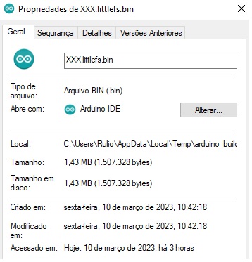

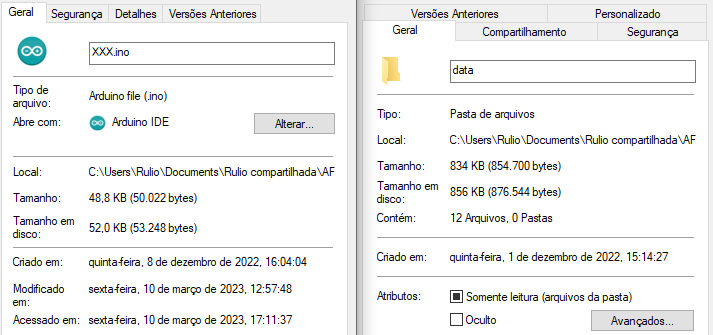

Hello, I have problem to update flash OTA
Connecting to: XXX.s3.amazonaws.com
Fetching Bin: /XXX.littlefs.bin
Got application/octet-stream payload.
Got 1507328 bytes from server
contentLength : 1507328, isValidContentType : 1
Not enough space to begin OTA
I'm starting on this subject, probably something went unnoticed.
I imagine it should have this file size.
Can someone help me?

Chip : esp32
Using partition scheme from Arduino IDE.
Start: 0x290000
mklittlefs : C:\Users\Rulio\AppData\Local\Arduino15\packages\esp32\hardware\esp32\1.0.6\tools\mklittlefs.exe
esptool : C:\Users\Rulio\AppData\Local\Arduino15\packages\esp32\tools\esptool_py\3.0.0\esptool.exe
[LittleFS] data : C:\Users\Rulio\Documents\Rulio compartilhada\XXX\data
[LittleFS] offset : 0
[LittleFS] start : 2686976
[LittleFS] size : 1472
[LittleFS] page : 256
[LittleFS] block : 4096
->/787.chunk.js
->/787.chunk.js.map
->/afira_logo2..png
->/asset-manifest.json
->/index.html
->/main.css
->/main.css.map
->/main.js
->/main.js.LICENSE.txt
->/main.js.map
->/manifest.json
->/robots.txt
[LittleFS] upload : C:\Users\Rulio\AppData\Local\Temp\arduino_build_454786/XXX.littlefs.bin
[LittleFS] address: 2686976
[LittleFS] port : COM14
[LittleFS] speed : 921600
[LittleFS] mode : dio
[LittleFS] freq : 80m
->esptool.py v3.0-dev
->Serial port COM14
erro (1).jpg (47.54 KiB) Viewed 792 times
