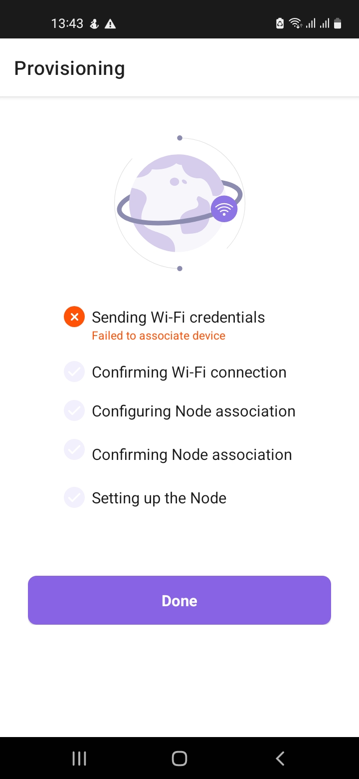

Wifi failing to connect,
Now I get the QR code and Bluetooth gave access, but when submitting the WiFi name and password
via the Android app I get "". On the ESP RAINMAKER when it is supposed to send WiFi credentials.
I tried with all example code provided by esp32 Rainmaker for arduino IDE.
failed to associate device
- Screenshot_20230224-134315_ESP RainMaker.jpg (118.92 KiB) Viewed 7440 times

Re: failed to associate device
Can you specify the version of ESP32-Arduino you are using? You can also refer the steps mentioned here https://blog.espressif.com/esp-rainmake ... 1474526172
I am using Arduino IDE 2.0.3 and ESP32 board manger 2.0.7, it was workings since last year until this week Monday where it just refuses to connect the wi-fi
Please attach any error logs you see on the Serial Monitor. Also, can you try building the sketch using ESP32-Arduino 2.0.6 from the Boards manager and check if the issue still persists?
Same issue here but downgrading the board manager to 2.0.6 made it work again.
I would like to draw attention to this issue and express my gratitude to Danielvrey for providing a solution. I was also able to resolve the problem by downgrading to version 2.0.6. It appears that version 2.0.7 has a bug.
