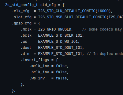

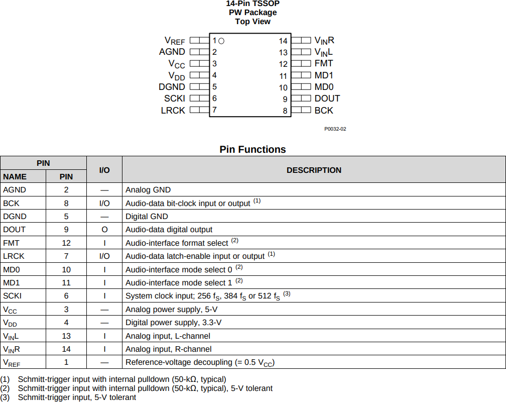

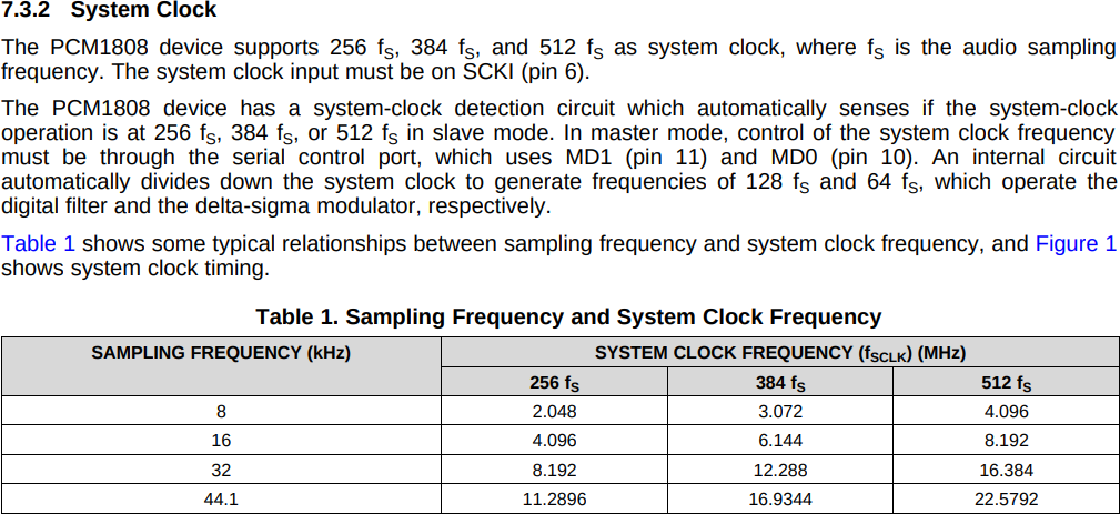

I'm currently using an ESP32-S3 to connect to a PCM1808 Audio ADC (https://www.ti.com/lit/gpn/pcm1808). The standard i2s example seems sufficient with one exception, the SCLK. The PCM1808 part requires a clock input which is it's sample clock:
In the i2s standard example (https://github.com/espressif/esp-idf/bl ... ple_main.c) there's the MCLK, BCLK, WS, and DOUT, but there is no SCLK:
So my question is, is there a way to create a "generic" clock output on a GPIO pin that's synchronous with other pins? Is there another more novel solution to this? The PCM1808 requires this clock to function, and surely there has to be a way to generate this clock, I'm just not familiar enough to know how.

Looks like 'system clock'/SCLK is TIs equivalent to MCLK.

Hi, yes the GPIO0 pin carries out the MCLK signal from I2S by default in the ESP32, it can go directly to pin 6 of PCM1808 (SCKI) or, better, you can do it through a 10 to 49 ohm resistor. As an example for plain ESP32 chip:
#define SAMPLERATE  48000
#define BITS	16
#define NUMCHANNELS 2
i2s_config_t i2s_config = {
	                .mode = I2S_MODE_MASTER | I2S_MODE_RX,
	                .sample_rate = SAMPLERATE,
	                .bits_per_sample = BITS,
	                .channel_format = I2S_CHANNEL_FMT_RIGHT_LEFT,
	                .communication_format = I2S_COMM_FORMAT_STAND_MSB,
	                .dma_buf_count = 4,
	                .dma_buf_len = 240,
	                .use_apll = true,
			.fixed_mclk = 256 * SAMPLERATE,
			.tx_desc_auto_clear = true,
	                .intr_alloc_flags = ESP_INTR_FLAG_LEVEL1                                //Interrupt level 1
In my example I fix the initial MCLK rate at 256 x sample rate, you can modify it to your needs or change it later in code.
//I2S pinout example configuration
	i2s_pin_config_t pin_config = {
	                .bck_io_num = 5,//BIT CLOCK(TO PIN 8 BCK IN PCM1808)
	                .ws_io_num = 25,//LR CLOCK(TO PIN 7 LRCK IN PCM1808)
			.mck_io_num = 0,//MASTER CLOCK(TO PIN 6 SCKI IN PCM1808)
	                .data_out_num = -1,//(NOT USED)
	                .data_in_num = 35//DATA IN(FROM PIN 9 DOUT IN PCM1808)
 	ESP_ERROR_CHECK(i2s_driver_install(I2S_NUM_0, &i2s_config, 0, NULL));
 	//this optional line reconfigures the default I2S asignment pins:
  	ESP_ERROR_CHECK(i2s_set_pin(I2S_NUM_0, &pin_config));
  	//this optional line configures the default MCLK rate:
  	ESP_ERROR_CHECK( i2s_set_clk(I2S_NUM_0, SAMPLERATE, BITS, NUMCHANNELS) );
