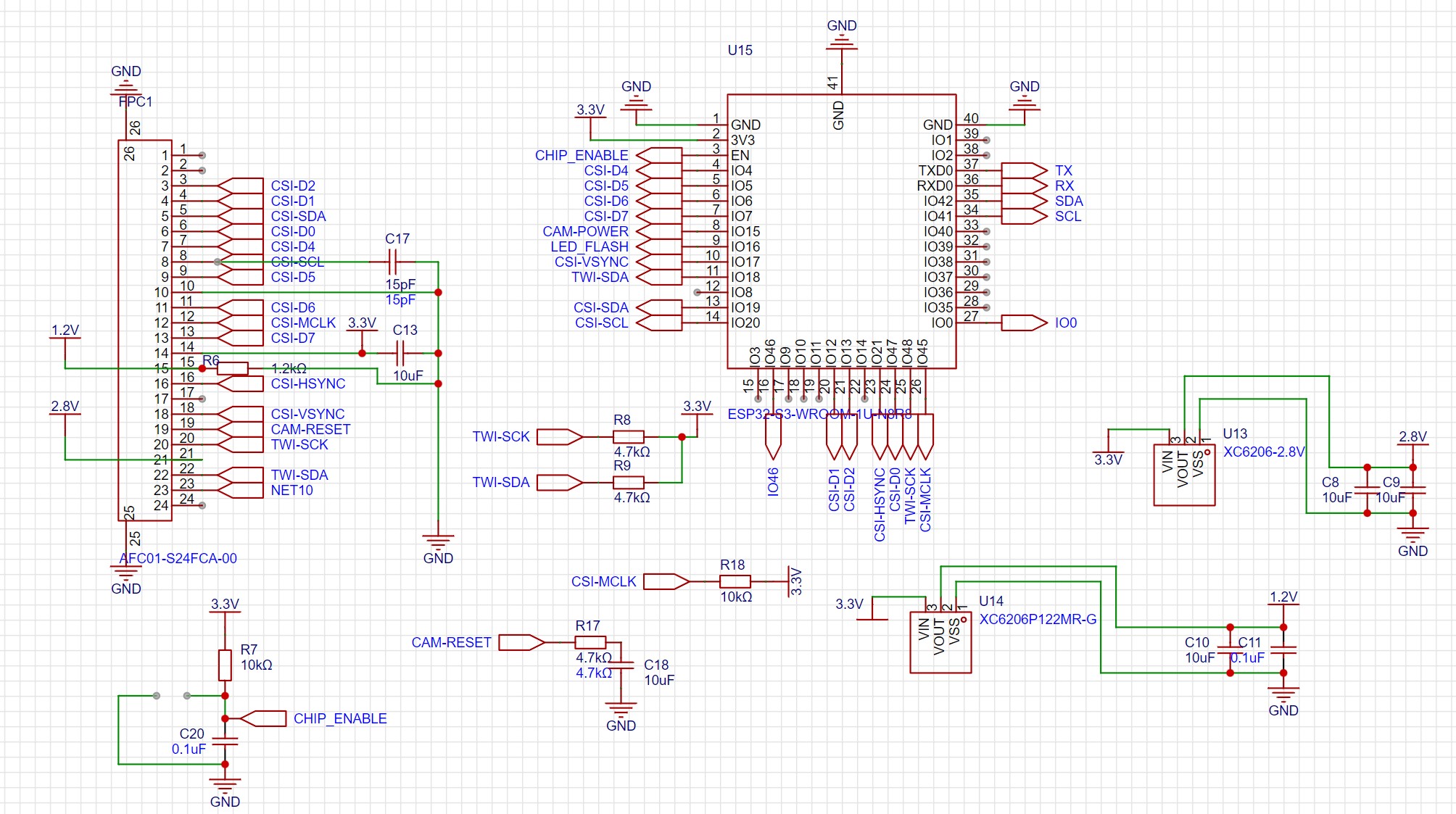

Hi there,
I've been trying around for hours to get my custom made PCB to work, but it does not want to. I designed everything in Easy-EDA Pro, and ordered everything with all parts placed from JLCPCB, the board came yesterday. I have the following schematics:

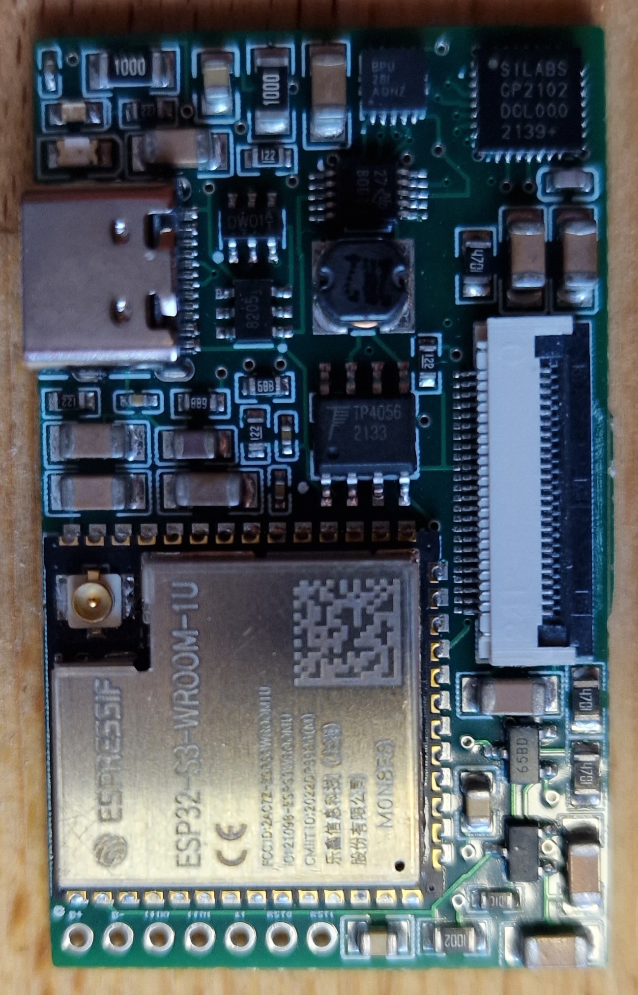

Here is the assembled PCB:

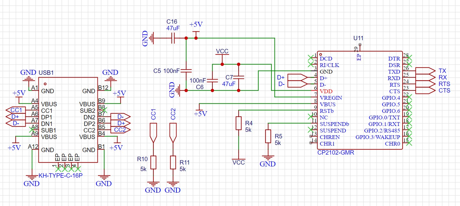

I wanted to build an ESP32 Cam myself, using the new ESP32-S3 model, instead of the old ESP32-S, that is discontinued but somehow still used in all ESP32-Cam chips. I have a few other schematic, but I don't think there is a problem with them, because one is for lipo charging (which works), one is for connecting the USB-C to the ESP32 with a CP-2102, connecting to the TX and RX of the ESP, and the other one is just a boost/buck circuit for generating stable 3.3V for the ESP (which works, too).
What I have done now is connected an USB-C cable to my PCB, I grounded IO-46 and IO-0 to boot to the bootloader. But I can't get a single signal from the ESP, the desktop ESP-Tool does not recognize it, and I've tried to hook up the RX/TX Pins of the ESP32, with an FTDI adapter whatsoever but nothing works.

So you could not see no log through TX RX, right? Do you make sure if TX RX are connected correctly? Could you make sure current requirement is met? I think you could provide complete schematic to us.

Hey there,
here are all my schematics (I unfortunately can not post more than 3 images on here for whatever reason so I uploaded it to imgur:
https://imgur.com/a/r7bCllL
If anybody can find something wrong, I would be so happy. My other thought would be, that in my PCB Design itself I made some wrong connections, let me know if you need that to (the gerber file itself)
I tried to solder wires to TX and RX and hook up a CH340C, a FTDI Adapter, but nothing shows any output. I think that maybe the ESP32 is not even booting but I can't be sure. Someone knows how I can troubleshoot that?

For one, TX of the CP2102 should go to the RX of the ESP32 and RX of the CP2102 should go to the TX of the ESP32. (Also, on your PCB design: don't put vias inside pads. When in production, they can wick away the solder from the pad, making a bad connection. It can be worked around by plugging the vias, but that's usually expensive.)

thanks for your reply! I will remove the vias. Can you explain why I need to connect RX to TX and TX to RX? Would you recommend to build a circuit for RTS and DTS like here?

Because on both the ESP32 and the CP2102, TX is the line that sends data (=output) and RX is the line that receives data (input). If you connect TX to TX, you're shorting two outputs, and if you connect RX to RX, neither device will be able to receive anything. That's the (or at least one) reason you don't get anything out of your ESP32: if it's trying to say something, your CP2102 is miswired so it can't receive it.
You can build that auto-reset circuit if you want to, your choice. Another option would be to forego the Cp2102 entirely and use the internal USB port of the ESP32-S3 to program/debug the chip; see here for more info on that.

THANK YOU SO MUCH!! Never would've thought of that, I was literally just about to throw it away but now i removed the CP2102 with a knife and sand paper (XD) and soldered wires to RX and TX to hook up to a CH340C. BUT
