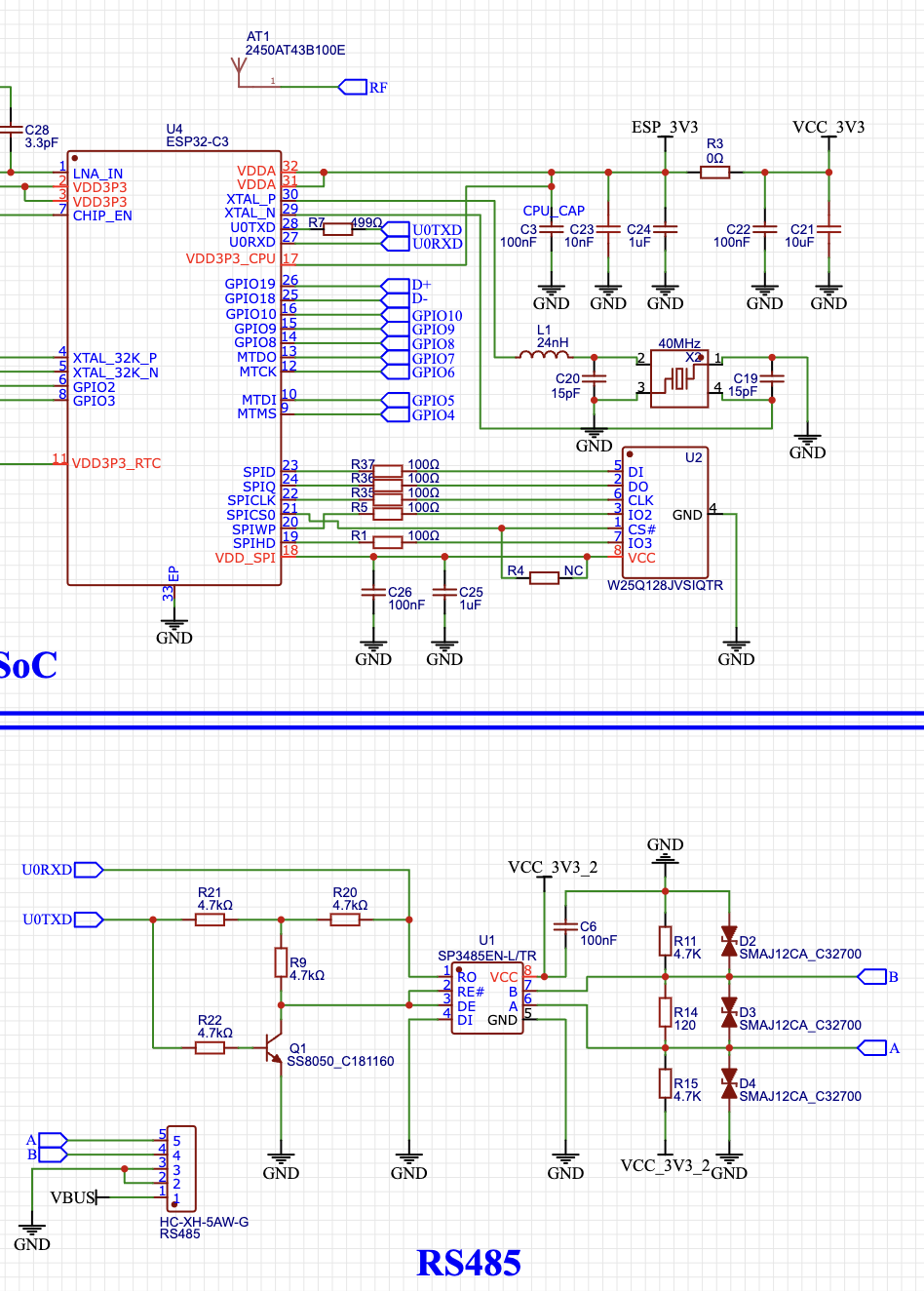

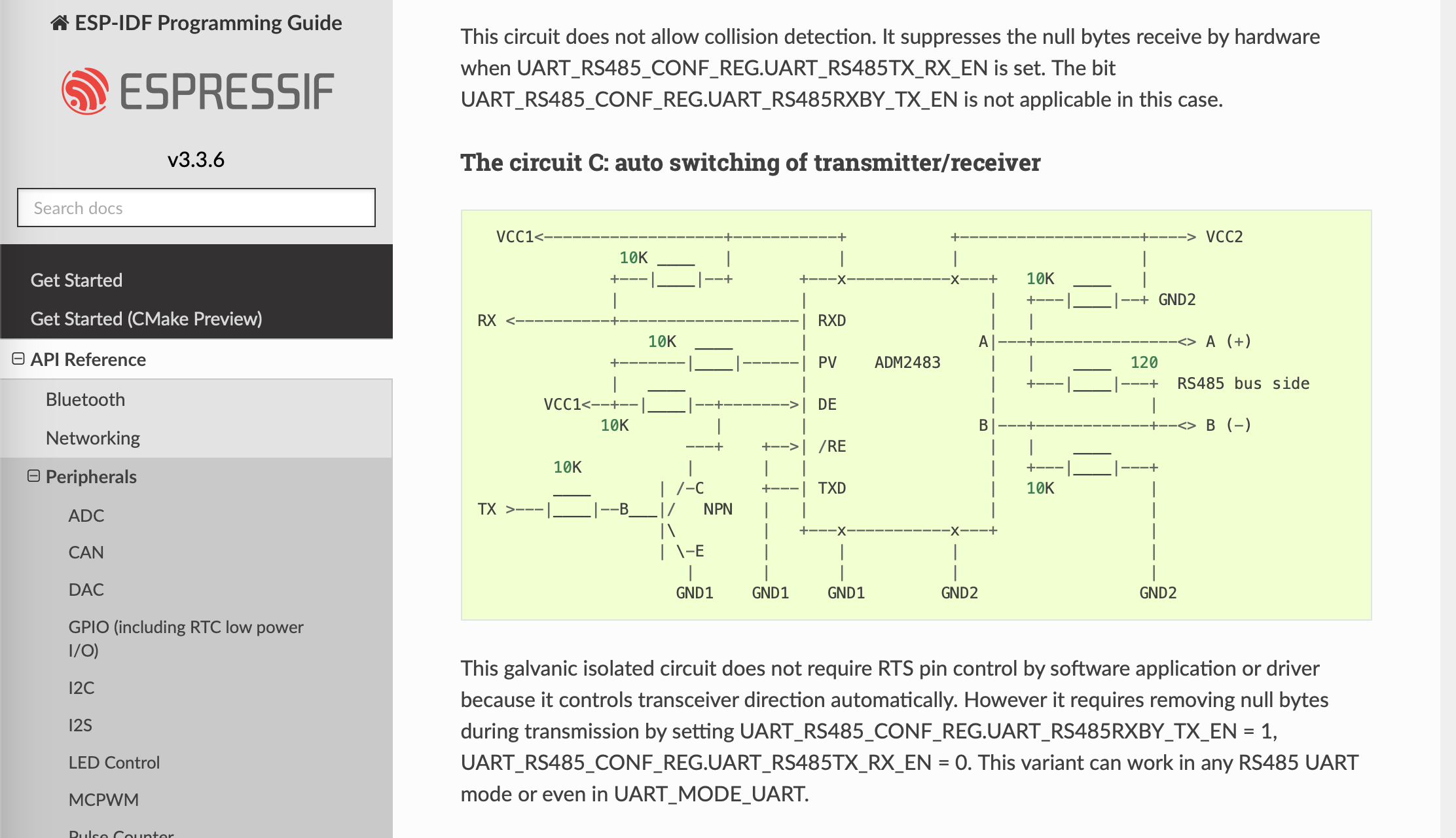

Hi, I am stuck also trying to use UART0 and U0TXD U0RXD as regular UART on ESP32-C3. It is a custom board. Where everything else works fine, connects to network, reads interrupts, and reads I2C line. For RS485 communication, I am using an "Auto direction control by transistor" scheme here.
https://iotips.tech/tag/esp32/
which is also used in a waveshare product. And works well with RP2040. I did a side by side comparison with an equivalent code using RPI PICO SDK.
https://www.waveshare.com/w/upload/0/02 ... -RS485.pdf
This kind of scheme where TXD pin is grounded is also in ESP's documentatation. Please see, The circuit C: auto switching of transmitter/receiver in the documentation
Screenshot 2023-06-08 at 02.00.04.png (377.2 KiB) Viewed 3791 times
, where TXD is grounded too:
https://docs.espressif.com/projects/esp ... /uart.html
Here is my schematic and code
Screenshot 2023-06-07 at 03.09.39.png (330.37 KiB) Viewed 3791 times
. I cannot get the RS485 device to respond on ESP32C3. Same Can you give me some leads please.
