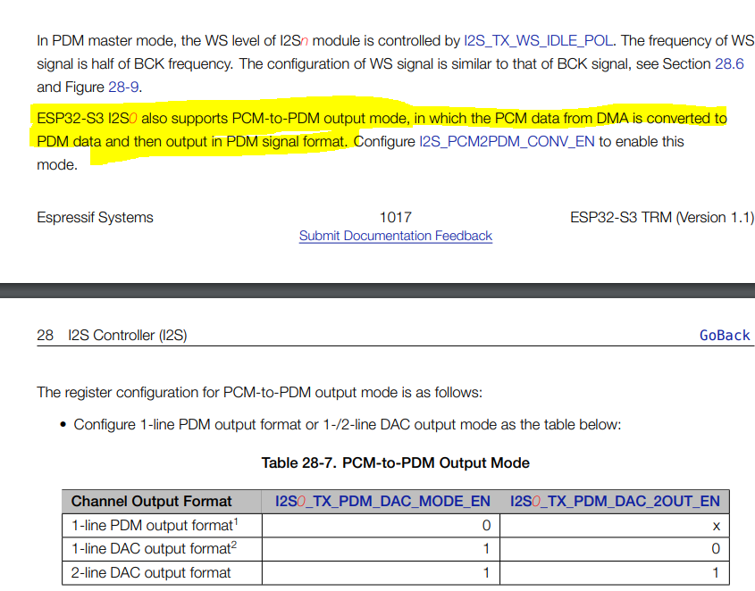

I want to create an audio pipeline where I take the output of the AFE Algorithm (16bit PCM) and via I2S0 stream it as PDM.

ESP32S3 TRM Ref
