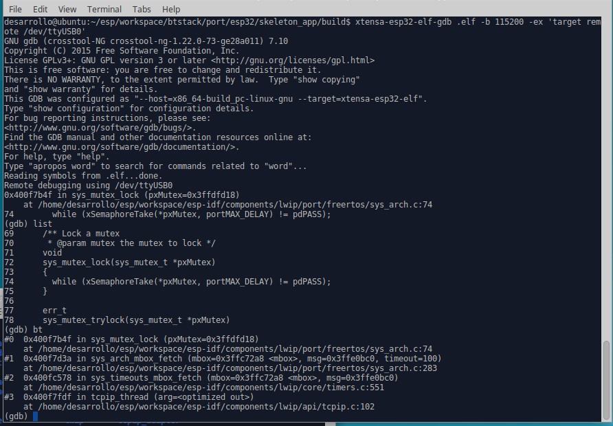

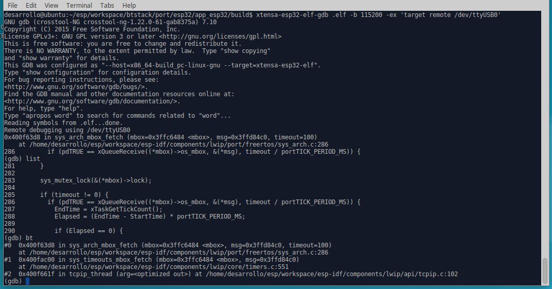

Dear Espressif Technical Support,
We are making a Development with the vision to acquire a considerable amount of ESP32 chips to implement in our solutions, but firstly is necessary to present the stable solution and we are having problems with one bug.
The app makes an interface between BTL and Wifi functions (specially UDP client connections) using the UART as bridge, and making the ESP32 works as peripheral with a master Board.
The problem is that time to time, when we need to send several data by UDP and with a considerable speed, suddenly the chip has a reset and we had to make the debug of the error, it seems to be provoked by something wrong in core libraries of ESP-IDF. But it happens suddenly, surely it will occur a reset, but sometimes before than others times. By the way, we update our environment with the latest version of toolchain and IDF to make the debugging and tests.
Please take attention to this issue because it is important to finish in time and we are waiting for your comments.
Really, we appreciate your attention,
Jonathan Gómez
Hardware development.
The images with the debug data are attached.

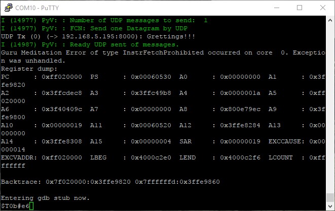

Now I got the same resets while I am sending by UDP but without message, and other times I got this debug data:
CONFIG_FREERTOS_CHECK_STACKOVERFLOW_CANARY=y
# CONFIG_FREERTOS_WATCHPOINT_END_OF_STACK is not set
And I tested with your advice:
CONFIG_FREERTOS_WATCHPOINT_END_OF_STACK=y
- Debug Data.jpg (114.75 KiB) Viewed 12448 times

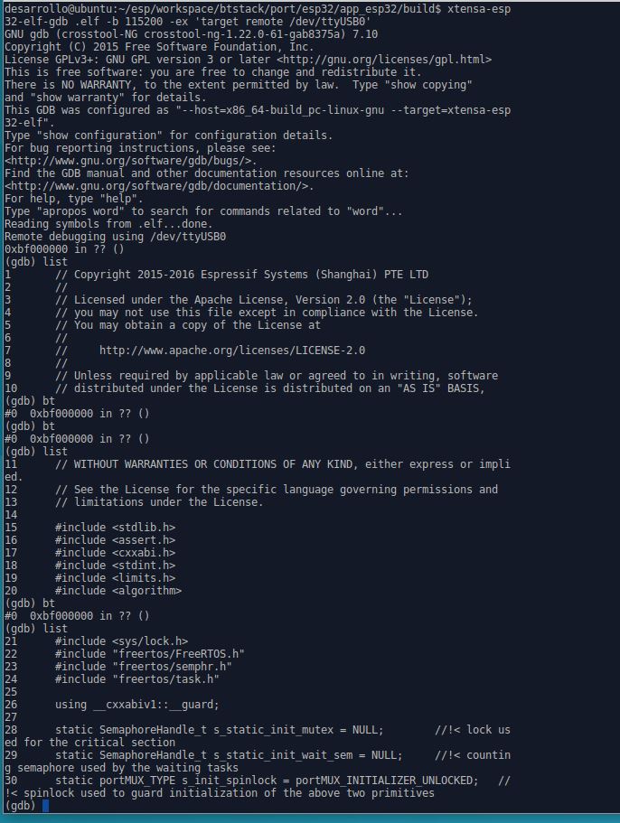

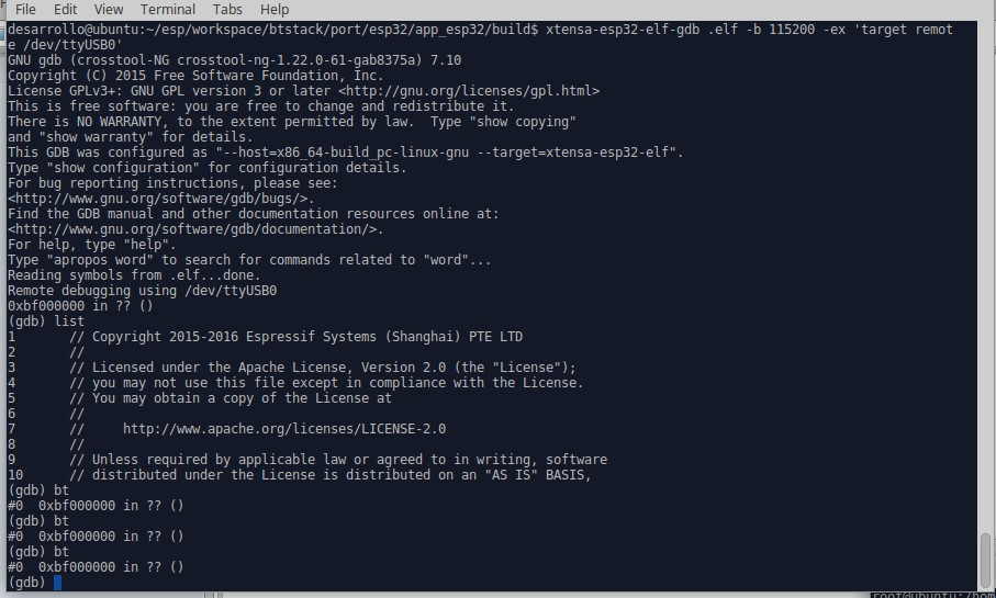

You may get more useful info if you disable GDBStub and leave just the default panic handler ("print registers and reboot" enabled).
Also, judging by the path you seem to be using BTStack... Are you able to reproduce the issue without it?

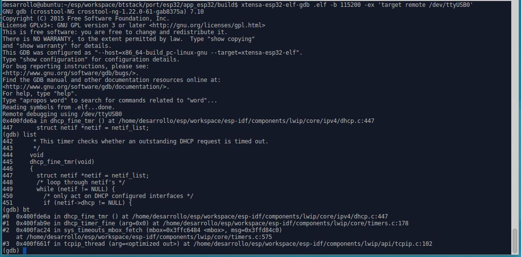

IMPORTANT: Really it seems that we have improved the performance with the program with your help and I believe we are closer to have the solution, as you say, the problem seems to be from 2 sources WiFi and BTL, I attach the debug info when suddenly the program breaks with three possible break points, and aditionally one issue in bt.c line 225.
Please, help us orienting to finish this project, remember it is just an application with some bluetooth fuctions in a inquiry BTL and transmit and receive data by UDP throught UART communication.
