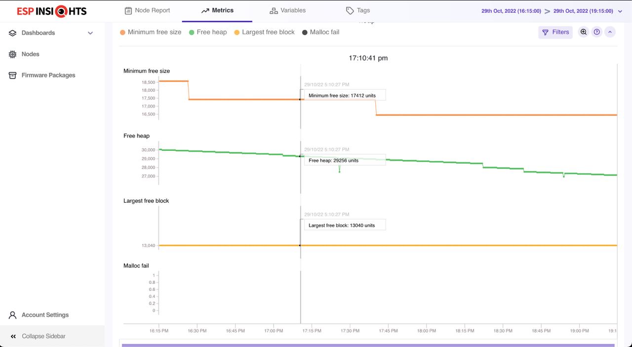

Is there a forum to ask for code reviews for ESP-IDF application code? Anyways, I'm having some problems putting together Direct Task Notification scheme between two tasks: pvoutput and modbus over here:
https://github.com/brainstorm/esp-modbu ... p_modbus.c
https://github.com/brainstorm/esp-modbu ... tput_org.c
I'm not sure I fully understand the Take/Give mechanism and TASK_ARRAY bits because I'm getting a lot of reboots, unfortunately (see log below).
Any pointers on why those Give/Take statements are misplaced (should emulate a binary semaphore) are very welcome!
I might just use plain semaphores instead of direct task notifications, but I also wanted to understand what am I doing wrong with direct tasks here...

chegewara
Posts: 2311
Re: ESP-IDF FreeRTOS Task notification(s) code review?
Postby chegewara » Sat Oct 29, 2022 10:38 am
i didnt study whole code, but it looks like you have created 2 tasks which should unlock each other with xTaskNotifyGive, but the problem is there is no initial notify and both task are awaiting in ulTaskNotifyTake:
https://github.com/brainstorm/esp-modbu ... dbus.c#L68
https://github.com/brainstorm/esp-modbu ... org.c#L109

Postby brainstorm » Wed Nov 02, 2022 9:03 am
Thanks chegewara, honored to get a reply from you, I casually check your IDF GH projects for reference and inspiration!
Indeed, I fixed it in this commit, just in case you are curious, thanks for your hints: https://github.com/brainstorm/esp-modbu ... e1b3335746
Now there's a more insidious problem with the heap usage according to ESP-Insights:
esp-insights heap usage
photo_2022-11-02 09.56.09.jpeg (46.58 KiB) Viewed 4345 times
Which tooling do you usually use for debugging/pinpointing heap usage? Any recommended static analysis tools to spot those things early before runtime (will test https://cppcheck.sourceforge.io and see if works)?
Also, for ESP-Insights devs: how come heap usage is expressed in "units" and not just bytes?
