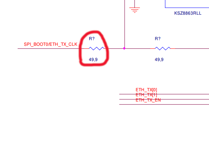

Hello. We faced some difficulties while we tried to send data through ethernet using the official driver for ksz8863 chip (https://github.com/espressif/esp-eth-dr ... er/ksz8863 ). The transmission speed is very low, ~13KB/s, that's incredibly low bandwidth. For this setup we connected the 50 MHz clock to GPIO_16 and set ETH_RMII_CLK_MODE to ETH_RMII_CLK_OUTPUT. We also set ksz8863_p3_rmii_internal_clk to true. We used the examples of the drivers source as the basis for our code.
We also tried to change the hardware to ETH_RMII_CLK_INPUT but then it returned a "reset timeout" error.
We tried different things (a little bit blindly) like inverting the P3 clock, setting the p3_rmii_internal_clk to false and so but anything we did worked.
Do someone had similar problems with ksz8863 chip or something similar or have some idea about how to debug it?

We tried with the iperf code you provided (changing the values of the I2C, P3 and so accordingly). My coworker, who develops the hardware part, have looked at the schematics and according to him we have almost the same schematics with the only difference we are using a 25 Mhz crystal instead of the 25 Mhz oscillator. If we configure it to output RMII clock from internal it is very slow (~0.03 Mb/s) but if we configure it to input RMII clock from external we have a reset timeout issue.
I attach the schematics we have of our system.

Why there is resistor with 49.9R value between REFCLKO_3 and REFCLKI_3? And why there is 1K pull-down?
Either:
- try to replace it 49.9R with 0R and desolder 1K. RMII REFCLK CONNECTION would be MODE 3 in this case and you should set ksz8863_p3_rmii_internal_clk to false.
- desolder 49.9R and keep the 1K (or better replace 1K with 10K). RMII REFCLK CONNECTION would be MODE 5 in this case and you should set ksz8863_p3_rmii_internal_clk to true.
Please consult with http://ww1.microchip.com/downloads/en/D ... 03048A.pdf
In general "reset timeout" error usually occurs when there is a problem with external clock. So you can also measure if CLK is present with oscilloscope at GPIO0.

Hi. We removed the 49.9R and put a 0R instead. The pull-down is not currently soldered to the PCB in our board.
We tried both mode 5 and mode 3 as suggested (setting p3_rmii_internal_clk accordingly)
We also tested that CLK was present at GPI0 but without success.
The error we face change between a "reset timeout" and an I2C error when executing the software reset. In the later case the error message we get is the next:

Just for sure, you tried it along with hardware changes right?We tried both mode 5 and mode 3 as suggested (setting p3_rmii_internal_clk accordingly)
Does it mean, 50 MHz CKL was present but you still had timeout error?We also tested that CLK was present at GPI0 but without success.
Anyway, it is strange. It still seems to me you have trouble with CLK integrity at GPIO0. Could you please try to desolder the other 49.9 ohm resistor as shown in the figure and replace it with 0R ?
