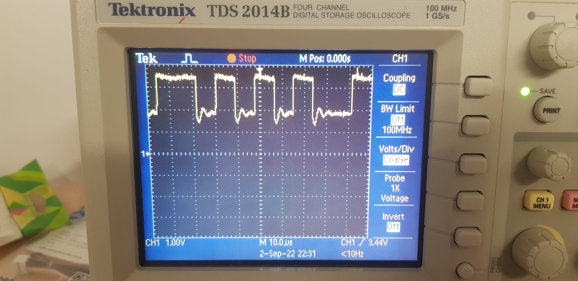

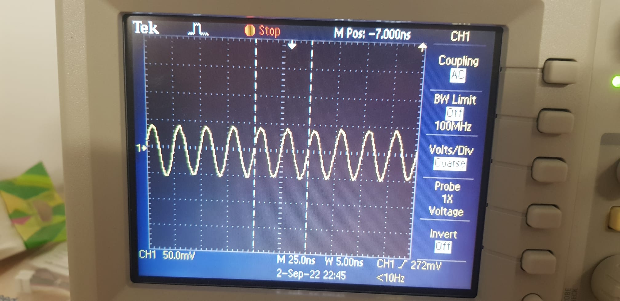

Re: ESP32 S2 FH4 First factory upload
I see the 3v3 and i don't see it dropping down.ESP_Sprite wrote: ↑Fri Sep 02, 2022 12:14 pmAgree that the schematic looks good. Some basic debugging:
- Is 3.3V present and stable?
- Can you see some activity on the crystal if you scope it?
- If you reset the chip, can you see serial chatter on the U0TxD pin?
I don't how how to accurately measure the crystal, but i see it go up in voltage on the scope.
When i check the U0TxD i see constant chatter. Update:
Managed to capture the sinage wave, so there is activity but the voltage of that does not get higher as 1v
- Posts: 9761
That looks good. Just to double-check: you are actually grounding GPIO0 while resetting / powering up the ESP32S2, right? Your board does not have an auto-reset circuit, so you need to set the state of GPIO0 to go into download mode rather than that happening automatically.
