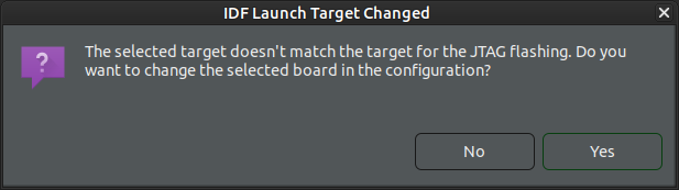

The dialog "Debug Configuration", tab "Debugger" does not contain the fields "Flash voltage", "Target" and "Board"!
The first problem after making these changes you can see in the attached screen shot. Nothing happens when I press one of both buttons! I can't recognize what I should change in the "Launch Target"!
The second unanswered question: I can select the serial interface "/dev/ttyUSB1" for flashing in the field "Launch Target" of the launch bar, but where do I enter the serial interface "/dev/ttyUSB0" for debugging?
This prompt could be because the "launch target" that you have selected on the eclipse toolbar is different from what is selected in the debugger configuration. Could you verify this? For example, esp32s3 would have selected on the launch target but in the debugger configuration tab "target" and "board" selections might be different. Based on the target and board selection, config options will be auto-shown.
This problem can occur for two reasons:
1. Empty the "OPENOCD_SCRIPTS" variable. To check it in the Eclipse, go to "Preferences -> C/C++ -> Build -> Environment -> OPENOCD_SCRIPTS".
2. "esp-config.json" may not be in the openocd folder. The path for it should be like this "..\.espressif\tools\openocd-esp32\v0.11.0-esp32-20211220\openocd-esp32\share\openocd\scripts\esp-config.json"

Now I'm a little bit further. After these changes:
The message window with the title "IDF Launch Target Changed" appears again...

In a new register in the middle window area with title "0x40000400" appears the message
Break at address "0x40000400" with no debug information available, or outside of program code.
with buttons "View Disassembly..." and "Preferences..." and the debugging is terminated.
What is going wrong now?
